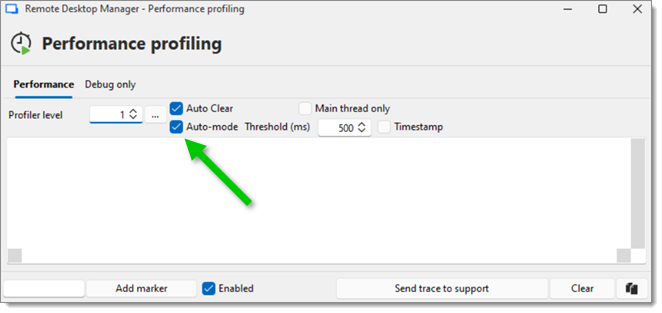

  1. The Profiler data will appear in the Performance Profiling window. Refresh Data Source
  2. Click on Send Trace to Support to send the Profiler data logs to our support team. You can add a Marker when running multiple tests to separate them.
  1. Select Help - Profiler. Help – Profiler
  2. Move the window to the side to display the Remote Desktop Manager main window and refresh the data source by using the refresh button or by using File – Refresh.
Holding the Ctrl key while performing the refresh will force a full reload of the data source, thereby ignoring the cache.
Perfromance profiling
  1. The Profiler data will appear in the Performance Profiler window. Performance profiling result
  2. Click on Send Trace to Support to send the Profiler data logs to our support team. You can add a Marker when running multiple tests to separate them. Send trace to support
