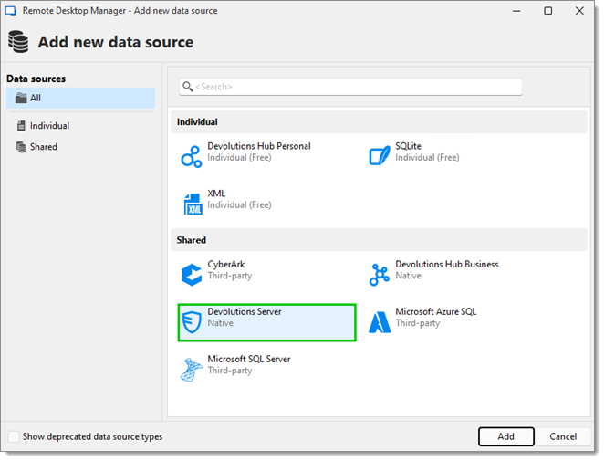

  1. In Remote Desktop Manager, go to File – Data sources.
  2. Click on Add a new data source.
  3. Select the type of data source to create, then click Add. In the example below, a Devolutions Server data source is being created.

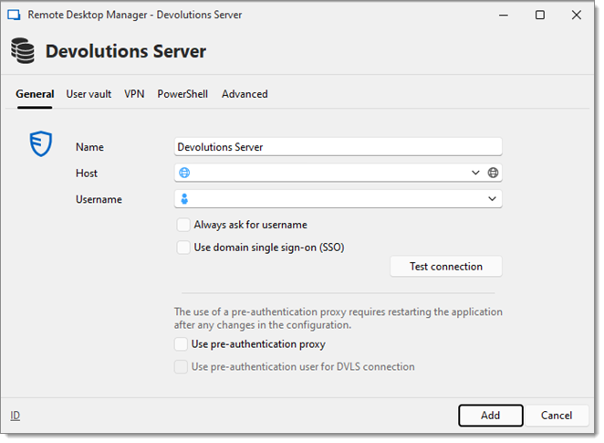

  4. Configure the data source connection settings. To validate the information, click on Test connection or Test host depending on the type of data source being created.
  5. Click Add when the configuration is complete.

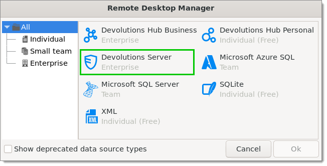

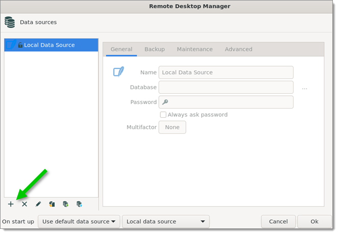

  1. In Remote Desktop Manager macOS, go to File – Data sources.
  3. Select the type of data source to create, then click OK. In the example below, a Devolutions Server data source is being created.
  4. Configure the data source connection settings. To validate the information, click on Test connection or Test server depending on the type of data source being created.
  5. Click OK when the configuration is complete, then OK again to close the Data sources window.

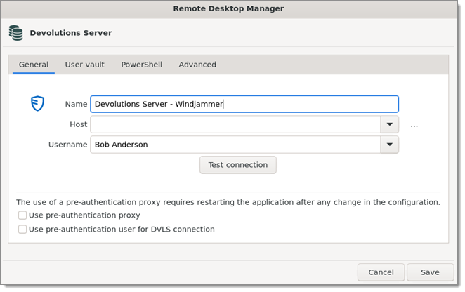

  1. Click Save when the configuration is complete.
  2. Once created, the new data source should automatically open. You can also manually open the data source by selecting it from the data source drop-down list at the top of the navigation pane.
