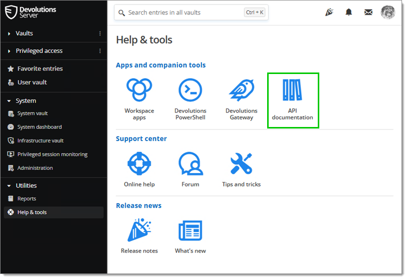

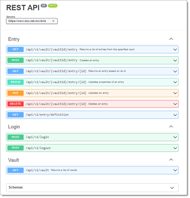

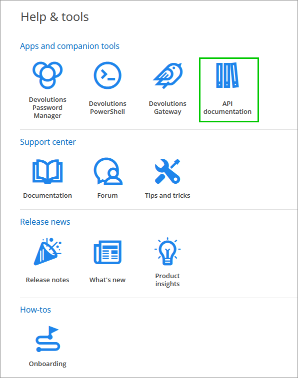

The Devolutions Server REST API documentation is built into the Devolutions Server web interface: open ***Help & tools*** – ***Apps and companion tools*** – ***API documentation***. The page shows the interactive OpenAPI (Swagger) description of every endpoint, read from `swagger/v1/swagger.json` on the Devolutions Server.
The REST API uses the base path `/api/v1` and authenticates with an application identity (application key and application secret) created in Devolutions Server.
<table><thead><tr><th width="320">ENDPOINT</th><th>DESCRIPTION</th></tr></thead><tbody><tr><td><code>POST /api/v1/login</code></td><td>Logs in with <code>appKey</code> and <code>appSecret</code> in a JSON body, and returns a <code>tokenId</code> to send in the <code>tokenId</code> header of the following requests. A failed login returns HTTP 401 with a message.</td></tr><tr><td><code>POST /api/v1/logout</code></td><td>Ends the session of the token.</td></tr><tr><td><code>GET /api/v1/vault</code></td><td>Lists the vaults.</td></tr><tr><td><code>GET /api/v1/vault/{id}</code></td><td>Returns one vault.</td></tr><tr><td><code>POST /api/v1/vault</code></td><td>Creates a vault.</td></tr><tr><td><code>PUT</code>, <code>PATCH</code>, <code>DELETE</code> <code>/api/v1/vault/{id}</code></td><td>Replaces, updates or deletes a vault.</td></tr><tr><td><code>GET /api/v1/vault/{vaultId}/entry</code></td><td>Lists the entries of a vault, 25 per page by default (<code>pageNumber</code>, <code>pageSize</code>, <code>sortOrder</code> 1 = ascending or 0 = descending, <code>sortField</code> = <code>name</code> or <code>path</code>). Filters: <code>path</code> (with <code>exactPath</code> to exclude subfolders), <code>tag</code>, <code>name</code>, <code>username</code>, <code>description</code>, <code>connectionType</code> (one or more values).</td></tr><tr><td><code>GET /api/v1/vault/{vaultId}/entry/{id}</code></td><td>Returns one entry. Options: <code>includePasswords</code>, <code>includeSensitiveData</code>, <code>resolveVariables</code>, <code>resolveOverrides</code> (all true by default), <code>property</code> (returns only the value of that property), and <code>checkoutDuration</code> for a privileged account. HTTP 403 is returned when a checkout of the entry is required, or when the application is not allowed to view the entry, its password or its sensitive data.</td></tr><tr><td><code>POST /api/v1/vault/{vaultId}/entry</code></td><td>Creates an entry.</td></tr><tr><td><code>PUT</code>, <code>PATCH</code>, <code>DELETE</code> <code>/api/v1/vault/{vaultId}/entry/{id}</code></td><td>Replaces, updates or deletes an entry.</td></tr><tr><td><code>GET /api/v1/entry/definition</code></td><td>Lists the entry types and fields that the REST API supports.</td></tr></tbody></table>
