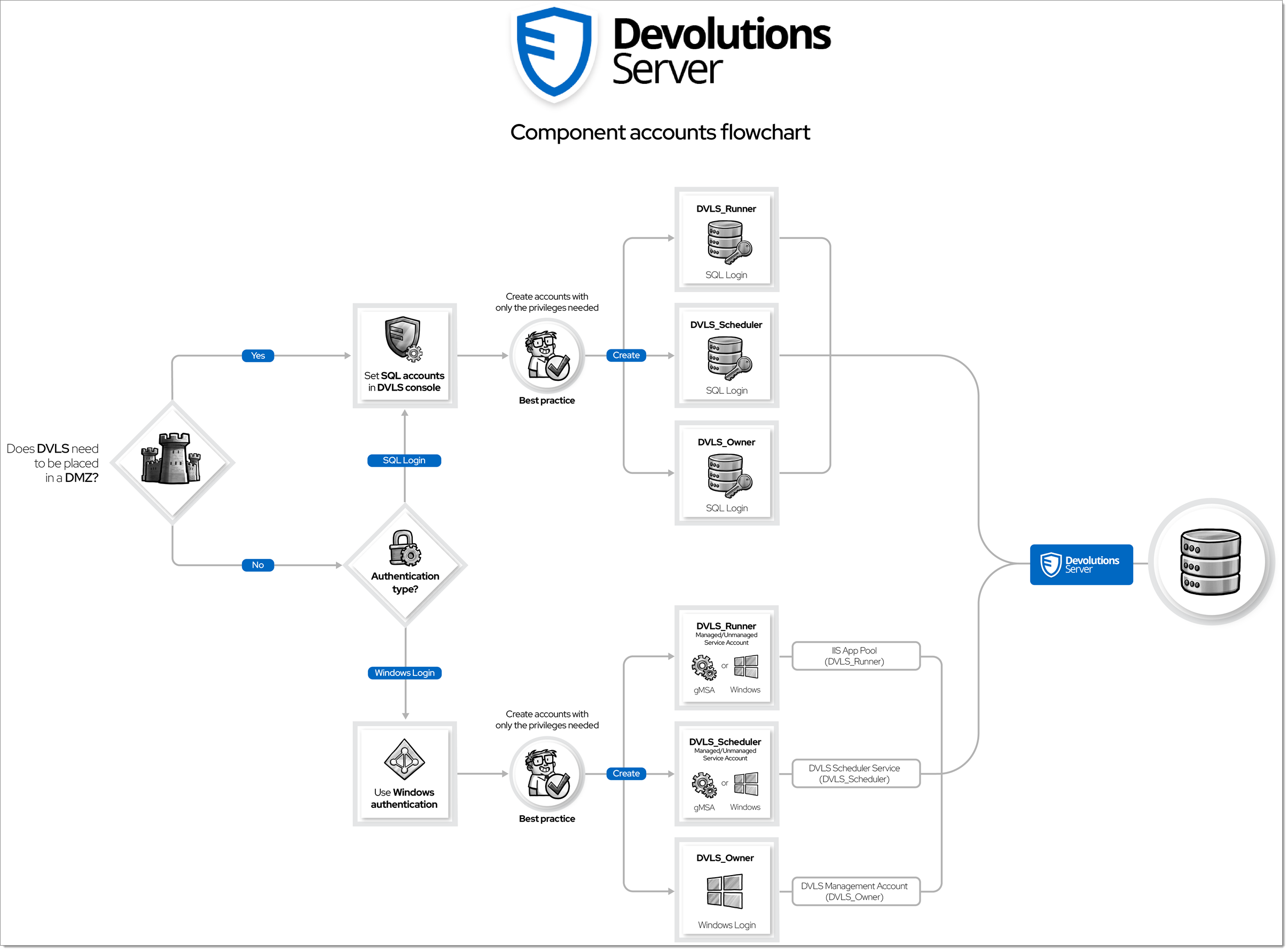

Account survey flowchart
Windows domain accounts (integrated authentication)
Devolutions Server supports the use of integrated authentication for Windows accounts. Typically, these accounts are managed in on-premise Active Directory environments or cloud-hosted Azure Entra ID.
It is recommended to use separate accounts for the different roles.

Windows SQL accounts
Devolutions Server supports SQL logins for non-domain joined Windows computers, or if non-domain accounts are to be used. It is recommended that you use separate accounts for the different roles.

Linux SQL accounts
Devolutions Server for Linux (Beta) does not require the same number of accounts as a Windows instance. It runs as a Kestrel application with a self-contained scheduler. Therefore, a single Linux user is required to run a Devolutions Server instance.
