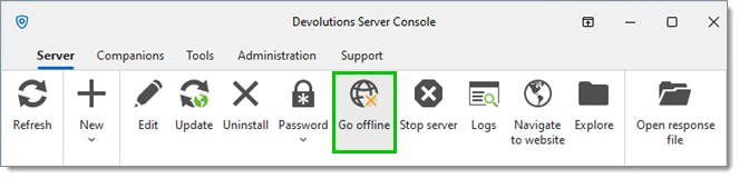

  2. Switch the Devolutions Server instance to offline with the Go offline button in the Server tab of the Devolutions Server Console.
Go offline
Go offline

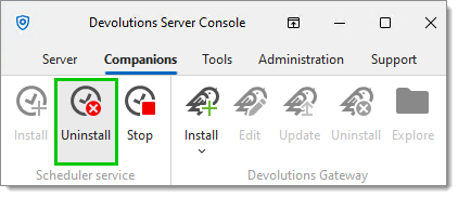

  1. If the scheduler is installed, uninstall it from the Devolutions Server Console in Companions – Scheduler service – Uninstall. If a service account is configured to run the scheduler service, make sure you have the service account's password to reinstall it at the end of the procedure.
Uninstall the scheduler

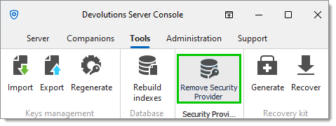

  3. In the Tools menu of the Devolutions Server Console, click on Remove security provider.

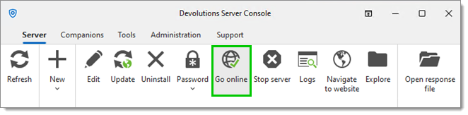

  1. Switch the Devolutions Server instance to online mode using Go online in the Server tab of the Devolutions Server Console.
Go online
Go online

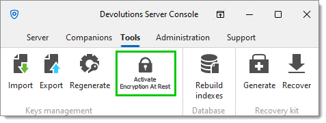

If the Activate encryption at rest button is not visible in Tools , it means that it is already enabled. In that case, please jump to step 15.
  1. Go in Tools in the Devolutions Server Console, then click on Activate encryption at rest. This step is essential to properly encrypt the data in the SQL database.
Activate Encryption At Rest

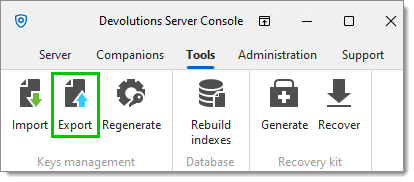

  1. Once completed, export the Encryption Keys. Make sure to save that file and the password in a secure place to be able to build another Devolutions Server instance connected to the same SQL database. Without those encryption keys, it is impossible to access the data.
We recommend not to store the encryption keys file and its password in your Devolutions Server instance.
Export encryption keys
Filename and File password

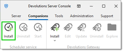

  2. If the scheduler service has been uninstalled in step 3, install it back from the Devolutions Server Console in the Companions tab.
Install the scheduler
