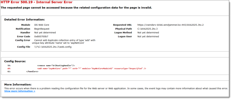

When trying to load the Devolutions Server web page, the following HTTP Error 500.19 - Internal Server Error is displayed in the browser:

The HTTP Error 500.19 - Internal Server Error is triggered by an ASP.NET issue at line 60. The solution is to edit the <handlers> in the web.config file located in the Devolutions Server Console installation folder.

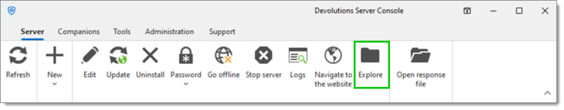

To locate the installation folder, open Devolutions Server Console and click Explore.

<handlers>
<remove name="MvcHttpHandler" />
<remove name="UrlRoutingHandler" />
<remove name="aspNetCore" />
<add name="aspNetCore"
path="*"
verb="*"
modules="AspNetCoreModuleV2"
resourceType="Unspecified" />
</handlers>
Save the file.
Restart the Devolutions Server Console.
