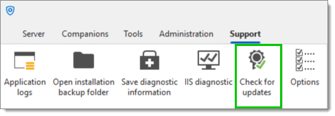

Go to the Support tab and click Check for updates.
Install the necessary updates, if any.

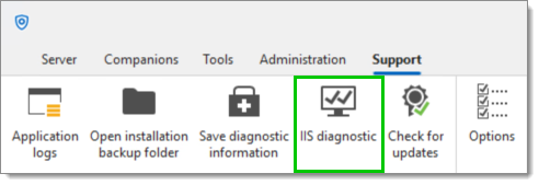

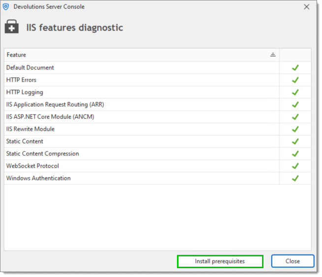

Click and run the IIS diagnostic.
Click the Install prerequisites button if any are missing.
