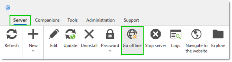

  4. In the Server tab, switch the Devolutions Server instance to offline mode by clicking Go offline.
