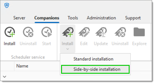

The Side-by-side installation will be used if you need to install Devolutions Gateway on the same machine where Devolutions Server is hosted. It is a simplified installation process that will automatically configure the new Devolutions Gateway with information from the Devolutions Server instance (access URI and public key).
To install Devolutions Gateway on another machine than the one where Devolutions Server is hosted, you need to follow the Standard (managed) installation process. The procedure is similar, but you will need to provide more information about your Devolutions Server instance to complete it.
This installation process is the easier of the two and is the recommended method for simpler network layouts.
From the Devolutions Server Console, click on the Companions tab.
Companions tab -
In the Devolutions Gateway section, click on Install.
Choose Side-by-side installation.
Side-by-side installation It is possible to download an .msi file to install Devolutions Gateway on an offline Devolutions Server.
If default values do not work for your environment, enter the desired settings.
HTTP Listener: HTTP(s) port to reach the Gateway. (7171 is default)
TCP Listener: port used for the RDP sessions. (8181 is default)
Click OK.

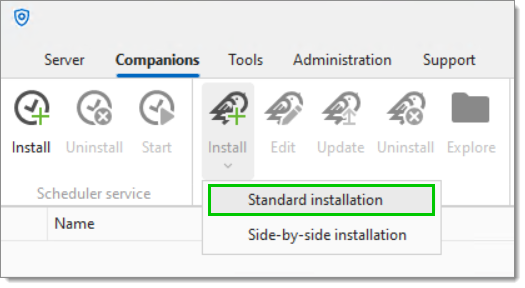

The Standard (managed) method allows Devolutions Gateway to be installed on a separate server than Devolutions Server. It could be for performance purposes or access networks that Devolutions Server cannot access.
Choose Standard installation.
Standard installation -
Choose between Download version and Install from .msi file.
Click Next.
Download version or Install from .msi file -
