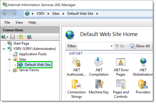

1. In IIS Manager, expand the root node, expand ***Sites***, then select ***Default Web Site***.

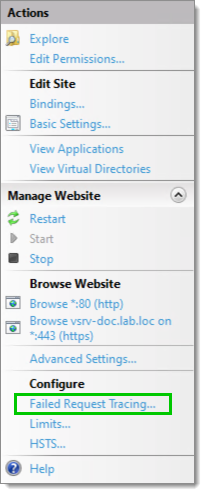

2. In the ***Actions*** pane on the right, select ***Failed Request Tracing***.

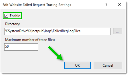

3. Check the ***Enable*** box (mandatory). The ***Directory*** target and ***Maximum number of trace files*** options can be customized (optional). Click ***OK*** when done.

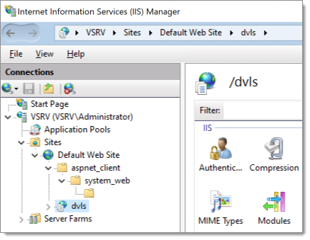

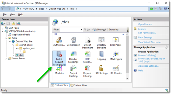

4. Expand ***Default Web Site***, then select the website to be traced.

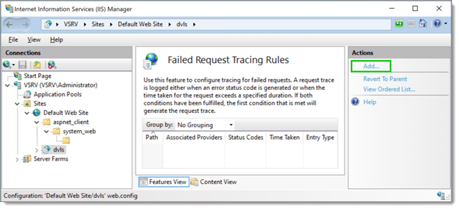

5. Double-click on the ***Failed Request Tracing Rules*** icon of the selected website.
6. In the ***Actions*** pane on the right, click on ***Add*** to add a new rule.

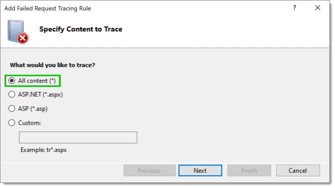

7. Select ***All content (*****)**\*, then click ***Next***.

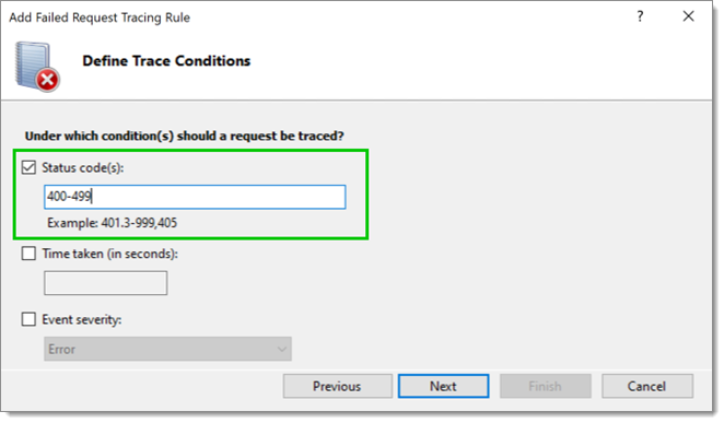

8. Check the ***Status Code(s)*** box, then enter the type of the status code to be traced. In this case, the ***Status code(s)*** is set to monitor everything from codes 400 to 599. Click ***Next*** when done.

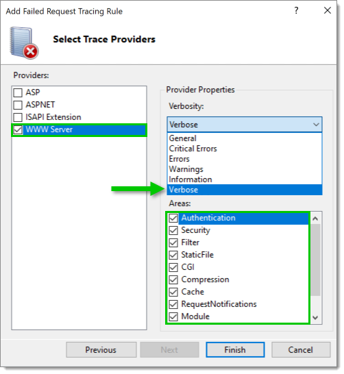

9. Select the providers of the tracing. For each provider, set the ***Verbosity*** to ***Verbose*** and select all ***Areas***. In this case, the ***WWW Server*** provider was selected.

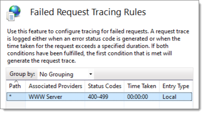

10. Click ***Finish***. The tracing rule is now defined.
