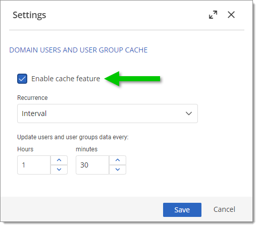

  • Active Directory cache
    • Activated through the Devolutions Server web UI in Administration – Server settings – Authentication – Domains – Settings – Enable cache feature.

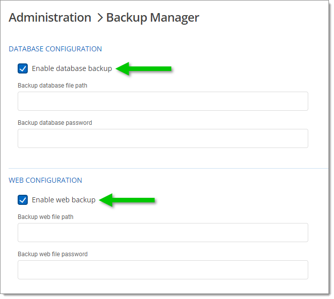

  • Backup manager
    • Mandatory when the Backup manager is enabled through the Devolutions Server web UI in Administration – Backup manager, either for:
      • Enable database backup.
      • Enable web backup.

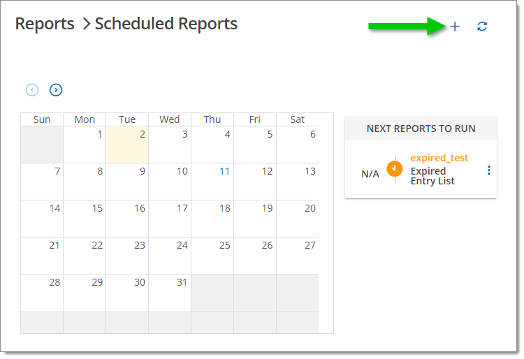

  • Automated reports
    • Mandatory when enabled. Set in the Devolutions Server web UI in Reports – Scheduled reports. Click the "+" icon to add a new Scheduled report.

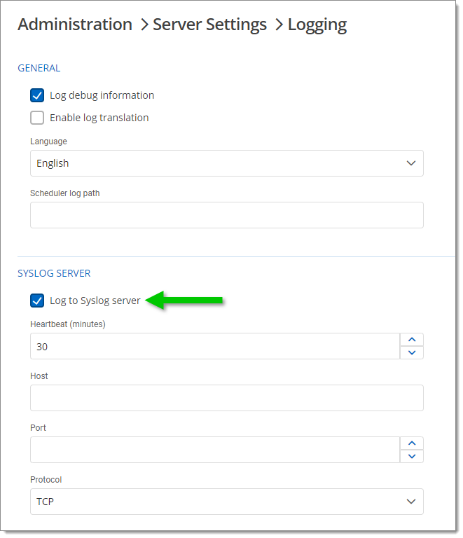

  • Syslog heartbeat
    • Mandatory when Syslog logging is enabled through the Devolutions Server web UI in Administration – Server settings – Logging – Log to Syslog server.

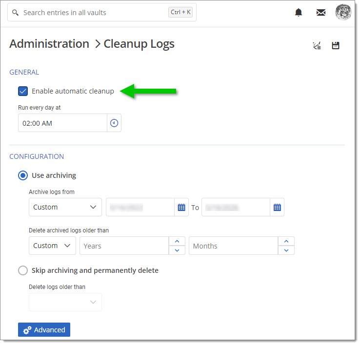

  • Automatic log cleanup
    • Mandatory when Automatic log cleanup is enabled through the Devolutions Server web UI in Administration – Logs – Cleanup logs – Enable automatic cleanup.

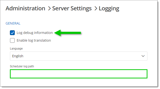

Enable Scheduler logging
  1. In the Devolutions Server web UI, go to Administration – Server settings – Logging.
  2. Check Log debug information, then specify a Scheduler log path to store the log files. The folder location is relative to the scheduler service (*C:* is the C drive of the server).
  3. Save your changes before leaving the Logging section.
  4. If it is not already the case, configure the identity running the scheduler so that it has the Write permission since it must write in the folder.
  5. Restart the Scheduler service.
