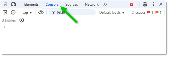

  2. Click the Console tab.
  3. Click the Clear button to remove any unrelated data.
  4. Reproduce the issue in the Devolutions Server web interface, as requested by our customer support team.
  5. Right-click anywhere inside the console output area, select Save as..., and save the file as a .log.

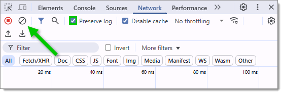

  6. Click the Network tab.
  7. Click the Clear button to remove any unrelated data and check Preserve log to ensure all actions are recorded.
  8. Reproduce the issue again.
  9. Click the Export HAR (arrow down) button to export the trace report.
