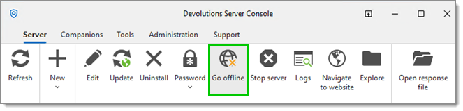

2. Switch the Devolutions Server instance to offline with the ***Go offline*** button in the ***Server*** tab of the Devolutions Server Console.

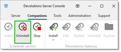

3. If the scheduler is installed, uninstall it from the Devolutions Server Console in ***Companions – Scheduler service – Uninstall***. If a service account is configured to run the scheduler service, make sure you have the service account's password to reinstall it at the end of the procedure.

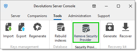

6. In the ***Tools*** menu of the Devolutions Server Console, click on ***Remove security provider***.
7. Click ***Yes*** when prompted to confirm the removal of the Security Provider.
8. The security provider was successfully removed. Click ***OK*** to close the window.

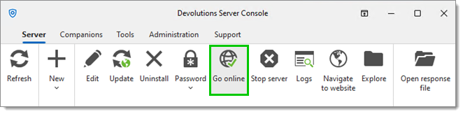

9. Switch the Devolutions Server instance to online mode using ***Go online*** in the ***Server*** tab of the Devolutions Server Console.
10. Once completed, verify that the data is available (entries' configuration, passwords, etc.). Verify the documents or attachments that exist in the database.
If Devolutions Server is installed in a load balancing / high availability topology, only remove the Security Provider on one node. Then, refresh the other nodes to notice that the Security Provider has been removed.

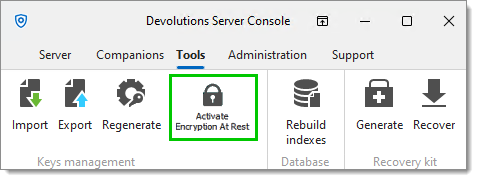

If the ***Activate encryption at rest*** button is not visible in ***Tools*** , it means that it is already enabled. In that case, please jump to step 15.
12. Go in ***Tools*** in the Devolutions Server Console, then click on ***Activate encryption at rest***. This step is essential to properly encrypt the data in the SQL database.

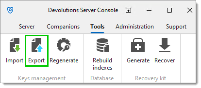

13. Once completed, export the Encryption Keys. Make sure to save that file and the password in a secure place to be able to build another Devolutions Server instance connected to the same SQL database. Without those encryption keys, it is impossible to access the data.
{% hint style="warning" %}
We recommend not to store the encryption keys file and its password in your Devolutions Server instance.

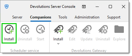

15. If the scheduler service has been uninstalled in step 3, install it back from the Devolutions Server Console in the ***Companions*** tab.
