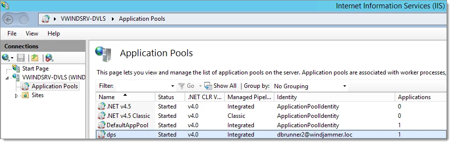

  1. Open IIS Manager.
  2. Expand the tree and select the Application Pools node.

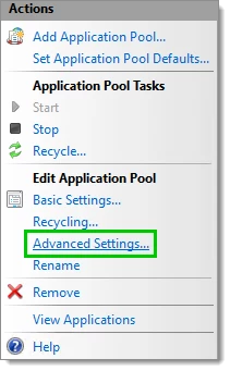

  3. Select the Devolutions Server application pool and open the Advanced Settings menu from the Actions pane on the right.

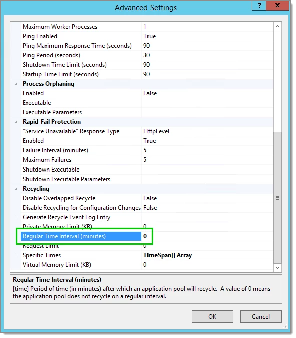

  4. Scroll the list at the bottom and set the Regular Time Interval to the value 0.

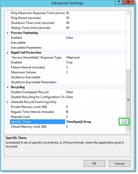

  5. Select the Specific Times parameter and click on the ellipsis button.

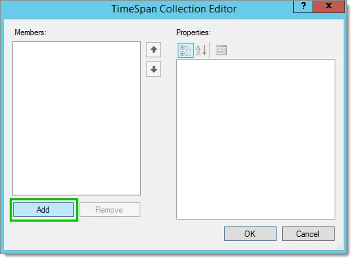

  6. Click on the Add button in the TimeSpan Collection Editor dialog to add a new entry.

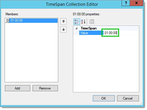

  7. Set the time when the application pool will be recycled. This time must be set as a 24 hour format.
  8. Finally, click on OK to save the modification.
