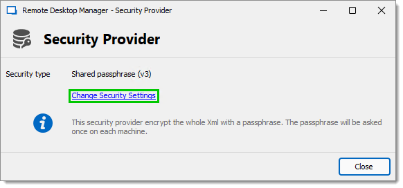

1. Go to the desired ***Microsoft SQL Server*** workspace.

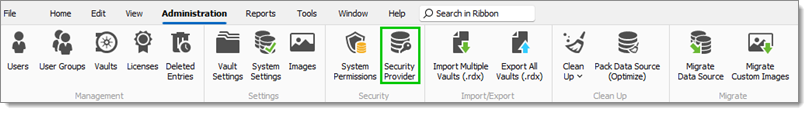

2. Select the ***Administration*** tab in the ribbon.
3. Click on ***Security provider***.

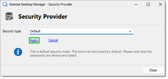

4. Click on ***Change security settings***.
5. In the dropdown select the ***Default*** option and click ***Apply***.

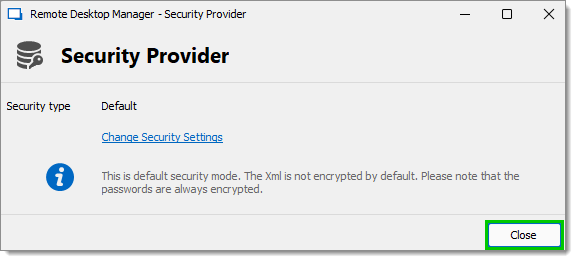

6. Click ***Yes*** after the warning window appears (this may take some time with larger data bases).
7. Click ***Close***.

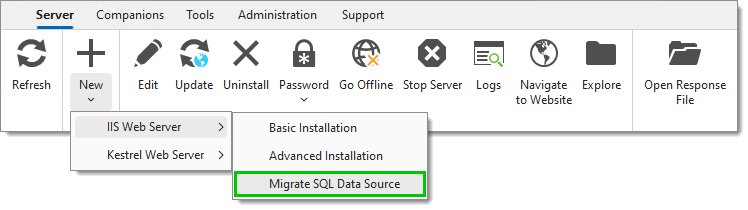

1. Open the Devolutions Server Console.
2. Navigate to ***Server*** – ***New*** – ***IIS Web Server*** – ***Migrate SQL workspace***.

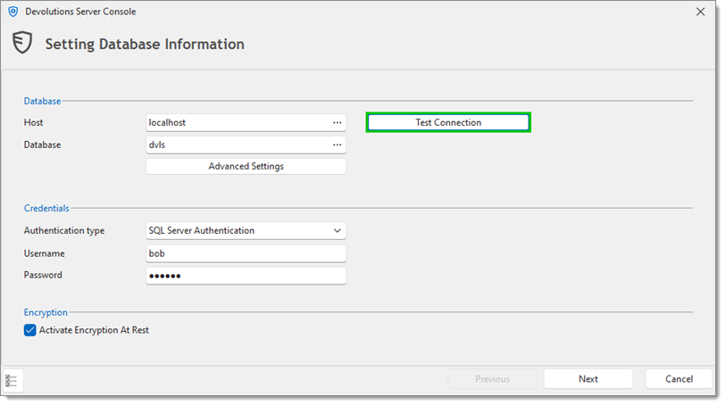

3. Enter the information in the ***Database*** and ***Credentials*** sections.
4. Enable ***Activate encryption at rest***. With this option enabled, a new `encryption.config` file is generated and data re-encrypted via the newly created key.

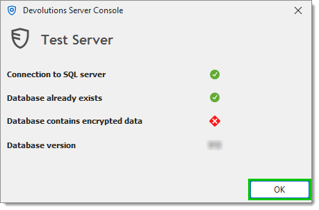

5. Click on ***Test connection***.
6. Click ***OK***.
The “Database contains encrypted data” warning is specific to Devolutions Server encryption keys and not default Remote Desktop Manager data encryption.

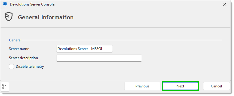

7. Enter the ***Server name*** and click ***Next***.

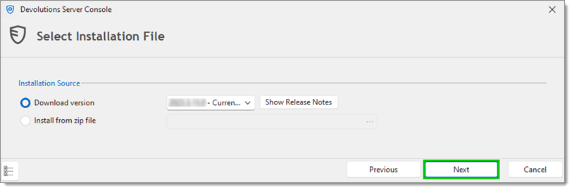

8. Choose which version of Devolutions Server to download and click ***Next***.

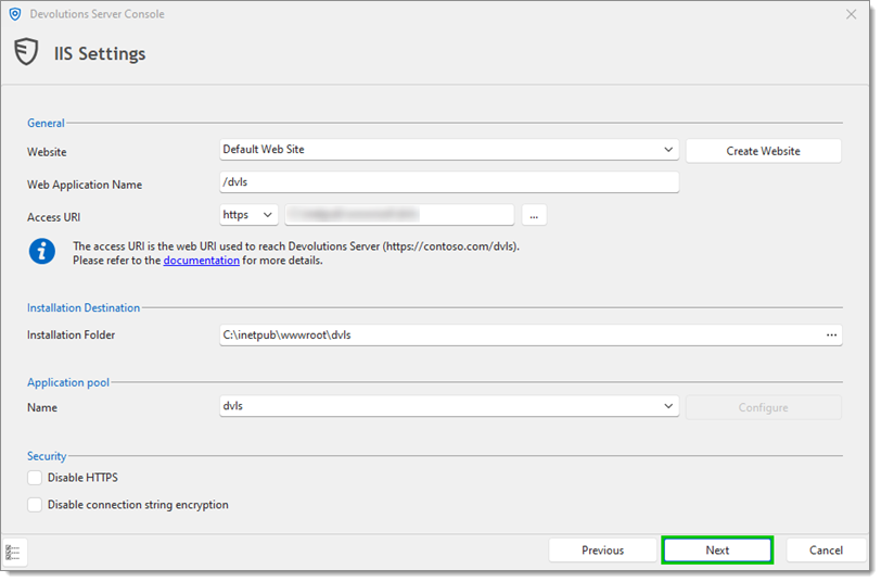

9. Fill the information fields for the ***IIS settings*** of the new Devolutions Server installation.

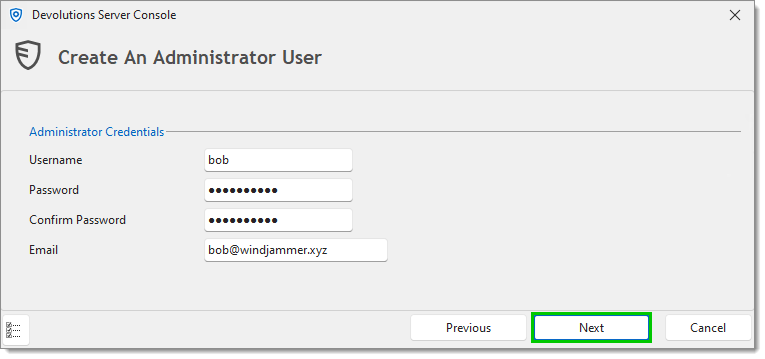

10. Enter the information for the new administrator user.
[Install the Scheduler Service](https://docs.devolutions.net/server/knowledge-base/knowledge-base-articles/scheduler-service-general-information.md) if this is the first instance of Devolutions Server Console.
