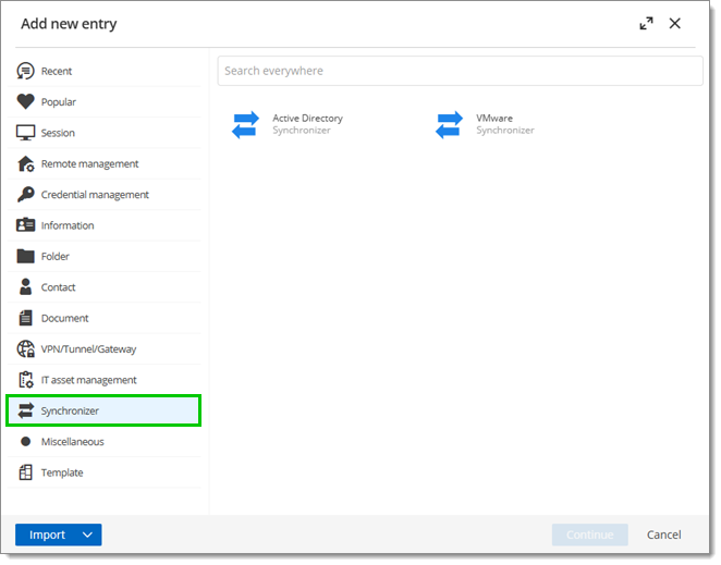

  1. From the Devolutions Server web interface, create a new Synchronizer entry.

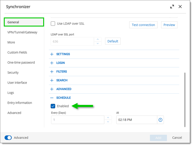

  2. Fill in the properties for the chosen Synchronizer entry.

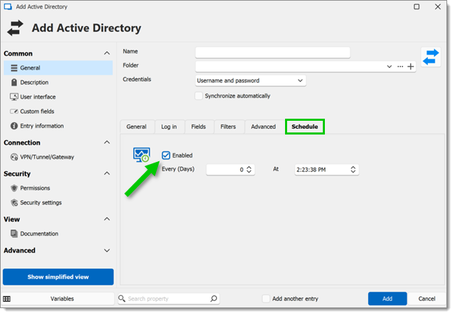

  3. Go in General – Schedule.
  4. Check the Enable box and set the occurrence and the time of the execution of the Synchronizer.
  5. This option can also be enabled in General – Schedule when configuring an Active Directory or VMware entry in Remote Desktop Manager.
