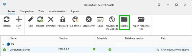

  2. In the Server tab click on Explore. This will open the installation folder.

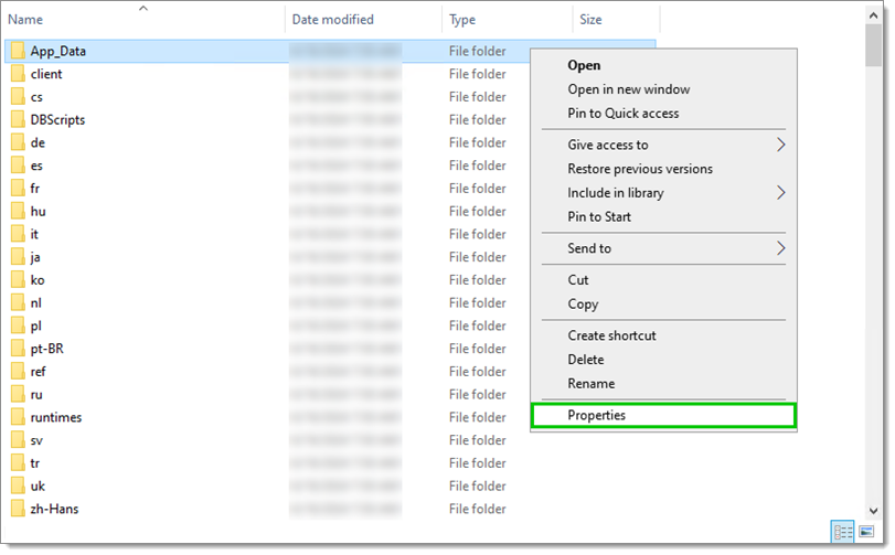

  3. Right-click on the App_Data folder and select Properties.

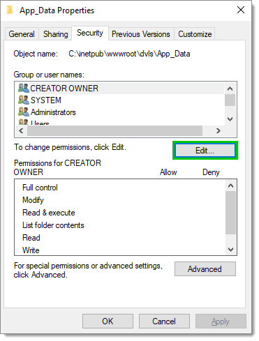

  4. In the Security tab click on Edit....

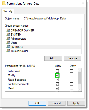

  5. Select IIS_IUSRS.
  6. Allow the Modify permission and click OK.

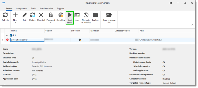

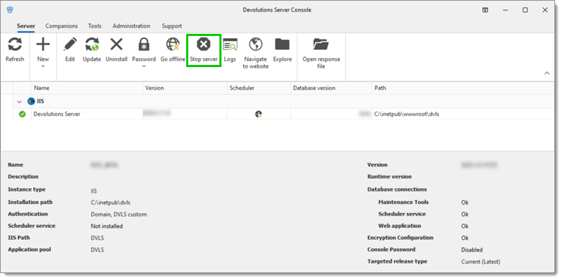

  8. In the Devolutions Server Console click Stop server.
  9. Wait for a few seconds and then click Start server. Restarting the server will create the DPS_Main.log and DPS_Main_001.log files after a short delay. Actions need to be taken on the Devolutions Server for logs to be created (logging in, etc).
