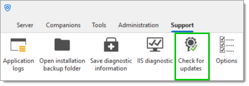

4. Go to the ***Support*** tab and click ***Check for updates.***
5. Install the necessary updates, if any.

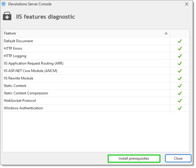

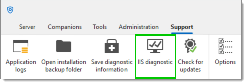

6. Click and run the ***IIS diagnostic***.
7. Click the ***Install prerequisites*** button if any are missing.

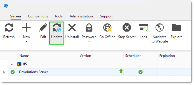

1. Open the [Devolutions Server Console](https://docs.devolutions.net/server/devolutions-server-console.md).
2. Select the instance to be upgraded.

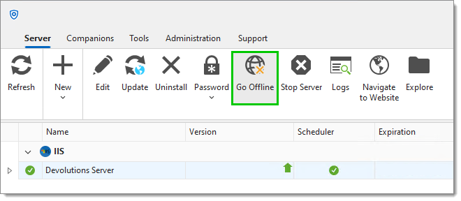

3. Set the instance to ***Offline mode*** with the ***Go offline*** button. In a high availability / load balancing topology, all instances must be set to ***Offline mode*** before initiating the upgrade process.
4. Click ***Update***.

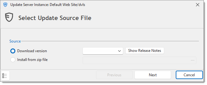

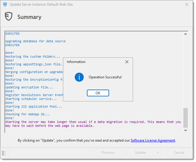

5. Select the upgrade source. Either choose the latest or extended maintenance release available online, or specify the path to a downloaded ZIP file. This option is typically used for beta releases or earlier versions.
6. Click ***Next***.

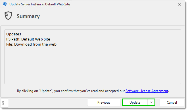

7. Review the summary and click ***Update*** once details have been confirmed.
The process will begin, and upon completion, a confirmation message will indicate that the operation was successful.
