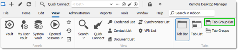

To enable the Tab group bar, navigate to View in the ribbon, then select Tab group bar.
The Tab group bar will only appear if a session that is part of a Tab group (other than the All tab) is active. To make it show at all times, check the Always show tab group bar box in File – Settings – User interface – Advanced. Tab groups are visible only if at least two sessions belonging to the same tab group are opened at the same time.

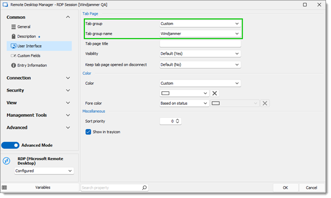

The Tab group settings are found in the User interface side menu of your session properties. The Properties option can be found when right-clicking on an entry.
The Tab group field lets you choose between a custom or inherited tab group. If you want to specify a custom name, you can simply type a name or choose an already existing one in the Tab group name field to create a tab group when launching an instance, then click on OK.
When the All group tab is selected, it performs no filtering. All running sessions are visible in this tab.
When a different group tab is selected, it hides all the sessions that do not match with the filter.
