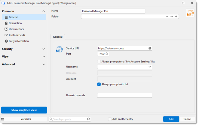

During the configuration of your Password Manager Pro credential entry, make sure that the URL of your server contains https:// and not http://. You absolutely need an https:// at the beginning of the address to communicate properly with the server.
