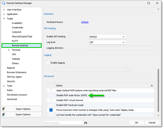

#### Method 3
In ***File – Settings – Types – Remote Desktop – Advanced***, uncheck the ***Disable RDP scale factor (HDPI)*** option.

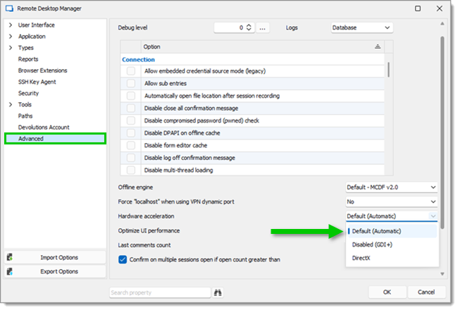

1. In Remote Desktop Manager, go to ***File – Settings – Advanced***.
2. Set ***Hardware acceleration*** on ***Default (Automatic)***. Click ***OK***.
3. In the ribbon under the ***Help*** tab, click on ***Diagnostic***.
4. At the bottom of the ***System*** tab, make sure that ***DirectX enabled*** is deactivated.
