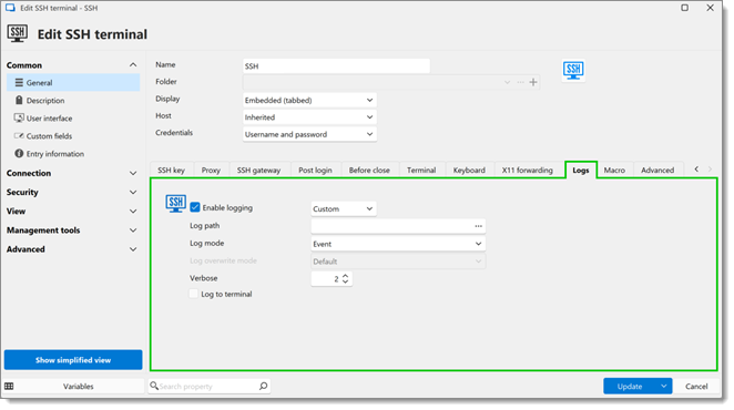

1. Enter the properties of your ***SSH Shell*** entry.
2. Go to the ***Logs*** tab.
3. Check ***Enable Logging*** option.
4. Put the ***Verbose*** at number 2.
5. Select ***Event*** as your ***Log Mode***.
6. Enter the location where your logs will be saved in the ***Log Path*** field and click on ***OK***.
7. Launch your session.
8. Send the resulting Log file to support by emailing it to <service@devolutions.net>.
