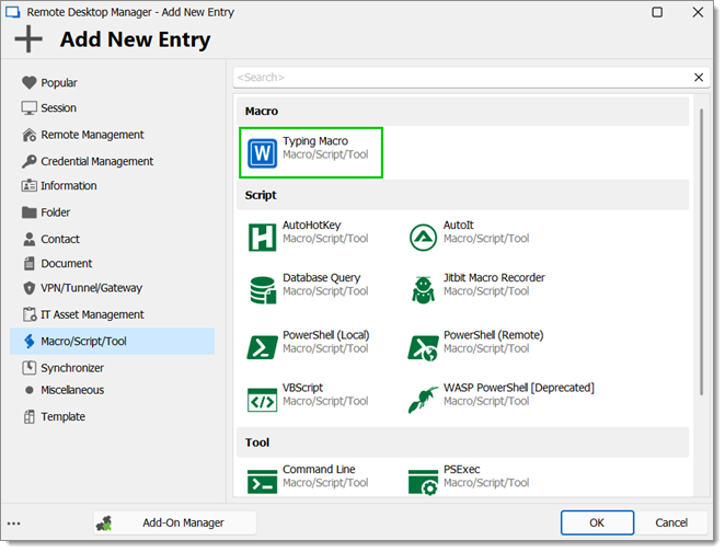

  1. Create a Typing Macro entry. It can be found under New Entry – Macro/Script/Tool – Macro.
  2. Click OK to save.

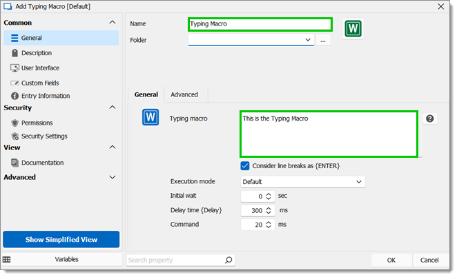

  3. Set your entry to any macro you want to input in your sessions.
  4. Click OK to save

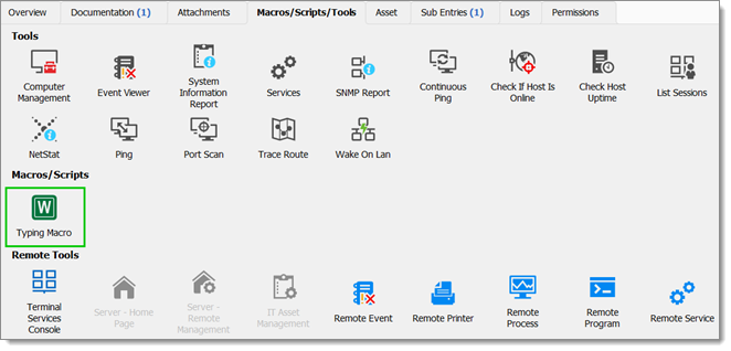

  5. Launch your sessions and select your macro under Macros/Scripts/Tools – Macros/Scripts. The macro will be sent directly into your sessions.
