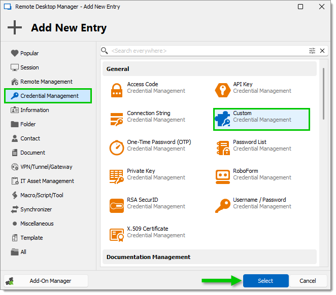

1. In Remote Desktop Manager Windows, create a new entry in the ribbon under the Edit tab. 2. In Credential management, select the Custom entry type.

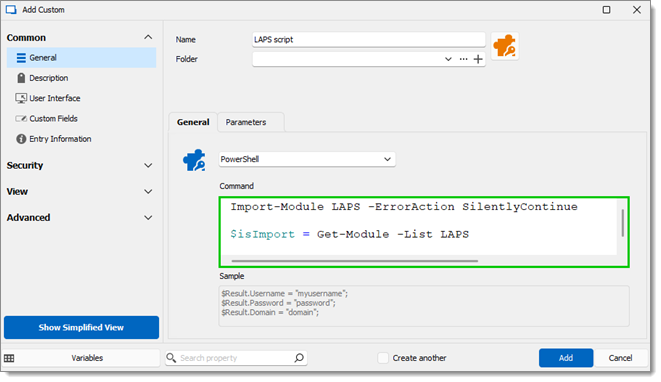

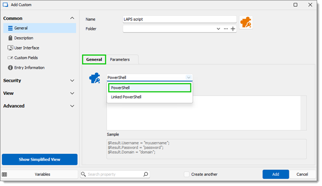

  2. In the General tab, make sure the drop-down menu is set to PowerShell.
  3. Add the following PowerShell script in the Command box.
    The script uses the $HOST$ variable for the -ComputerName switch of the Get-LapsADPassword cmdlet and uses the $PARAMETER1$ variable for the username (see step 6 below). Depending on your environment, the $PARAMETER$ could be related to the -Identity. You can also configure the Parameter #2 to set the username you need and change the script value from %USERNAME% to $PARAMETER2$. We recommend to launch Remote Desktop Manager as an administrator to gain elevated permissions.

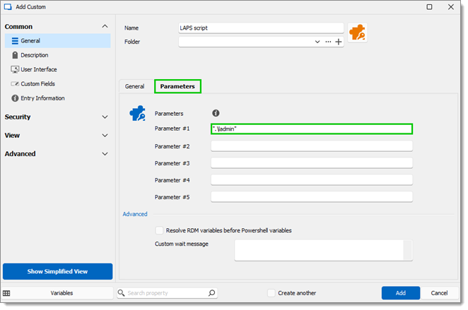

  1. In the Parameters tab, add the local administrator account name in the Parameter #1 field.

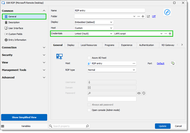

  3. In your RDP entry properties, set the credentials property to use the newly created Custom credentials entry.

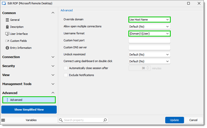

  4. Still in the RDP entry properties, go to Advanced – Advanced.
  5. Set the Override domain property to Use Host Name and the Username format property to {Domain}\{User}.
  6. Click on Update to save your changes.
