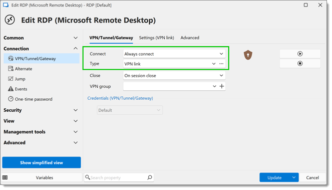

You must first create a VPN entry, then do the following:
1. Select the RDP entry.
2. Go in the properties of your RDP entry, under ***VPN/Tunnel/Gateway***.
3. Set ***Connect*** to ***Always connect***.
4. Set ***Type*** to ***VPN link***.

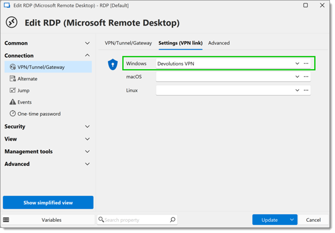

5. Go under the ***Settings (VPN link)*** tab at the top.
6. Use the ellipsis (...) button to select the ***VPN*** entry you have created.
7. Click ***Update*** to save and close the window.
8. Launch your RDP entry which will first open the VPN you have configured to establish the connection.
