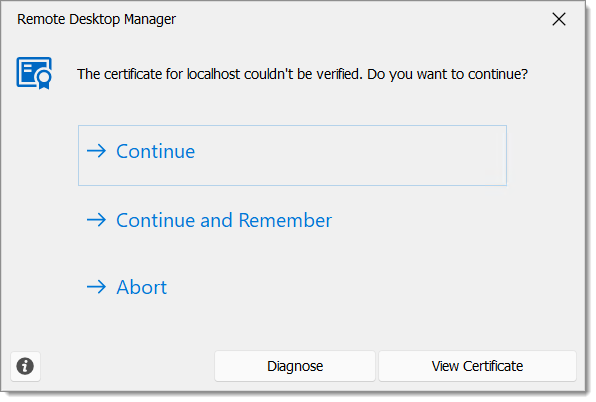

Remote Desktop Manager indicates a certificate validation error by displaying "The certificate for localhost couldn't be verified. Do you want to continue?".
The dialog offers five commands:
Command
Description
Continue
This option will accept the certificate for this session only.
Continue and Remember
This option will accept the certificate and remember your choice. To "forget" a certificate that had been previously added, you must clear the certificate exemption list using the Certificate security-related options.
Abort
This option will abort the communication that is being attempted, it will result in an unreachable error.

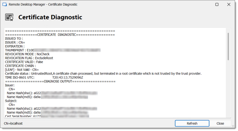

Diagnose
This option will display the Certificate Diagnostic Window.

Remote Desktop Manager Certificate diagnostic window

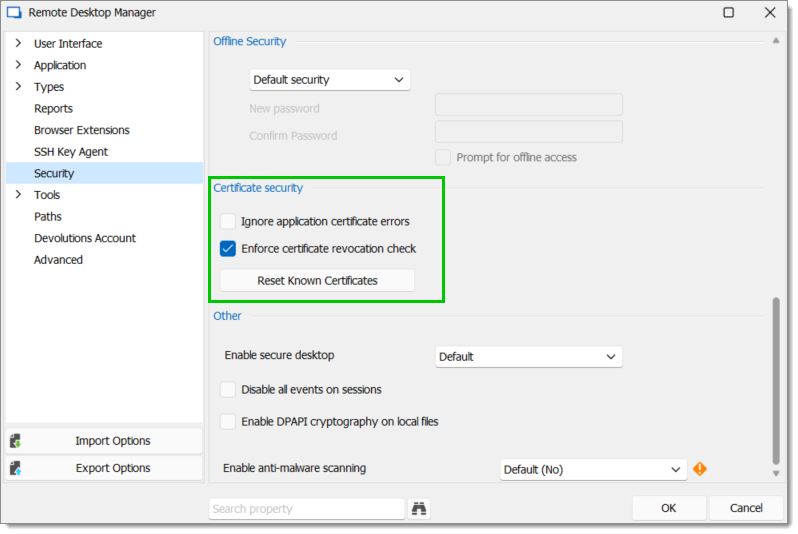

Navigate to File – Settings – Security – Certificate security to manage options related to certificates.
The Reset Known Certificates option only appears if you have selected Continue and Remember on one or more certificate.
Option
Description
Ignore application certificate errors
Enable this option to disable the application certificate validation. This is not recommended, as it would compromise confidentiality and integrity of communications between the client and the server and could expose the application to potential threats.
Check for server certificate revocation
This option checks that the certificate has not been revoked. This is necessary if any of the URLs for Certificate Validation are unavailable for any reason.
Use this option to clear the cached certificates. All certificates will need to be validated again.

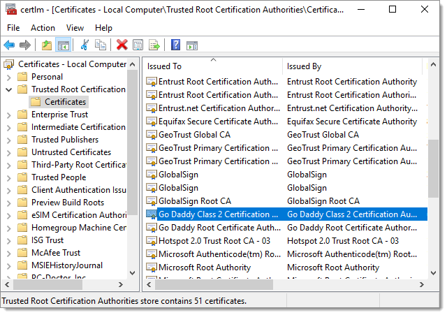

Verify the Certification Authority (CA)
  1. Open the certificate, then verify by which Certification Authority the certificate has been Issued by, in the General tab.
  2. Verify that the Certification Authority is properly installed in the certificate store.

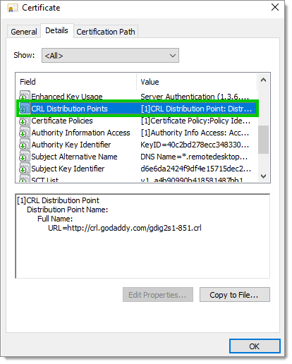

Certificate revocation check
Ensure that the CRL (Certificate Revocation List) server is reachable as it is required to validate a certificate.
