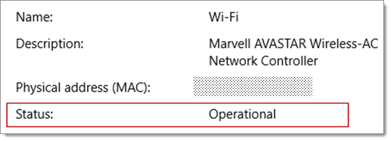

* PC internal IP address: Look in ***Settings - Network & Internet - Status - View your network properties*** Find the network configuration with an "Operational" status and then get the IPv4 address.
