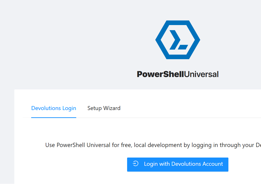

## Developer License
You can obtain a free developer license by logging in with a [Devolutions Account](https://docs.devolutions.net/portal/profile/create-your-devolutions-account). Using a developer license allows for use in non-production workloads. You can use this license for developing or testing PowerShell Universal.
During the first run wizard, you will be presented with the option to login with a Devolutions Account. After doing so, you will be redirected back to PowerShell Universal with a license installed.

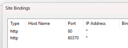

#### IIS
If you want to use IIS as mechanism for hosting your development instance of PowerShell Universal, you will need to set the static login port as part of your `web.config` file.
{% code overflow="wrap" collapsedlinecount="10" %}
```xml
<configuration>
  <system.webServer>
    <handlers>
      <add name="aspNetCore" path="*" verb="*" modules="AspNetCoreModuleV2" resourceType="Unspecified" />
    </handlers>
    <aspNetCore processPath="Universal.Server.exe" arguments="--appsettings .\appsettings.json" forwardWindowsAuthToken="false" stdoutLogEnabled="true" stdoutLogFile=".\logs\log" hostingModel="OutOfProcess">
      <environmentVariables>
        <environmentVariable name="PSULoginPort" value="60370" />
    </environmentVariables>
    </aspNetCore>
  </system.webServer>
</configuration>
{% endcode %}
After doing so, you will need to add a new binding for the login port.
