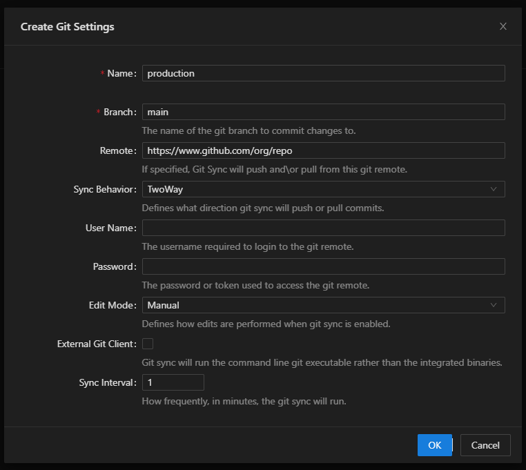

Git sync can be configured in the database by adjusting the settings within the admin console. This is the preferred approach. The benefit is that when you connect new instances of PowerShell Universal to your SQL instance, you will not need to configure git sync again.
To configure git sync, navigate to Settings \ Git within the Admin Console. You will be able to click the Create Git Settings button.

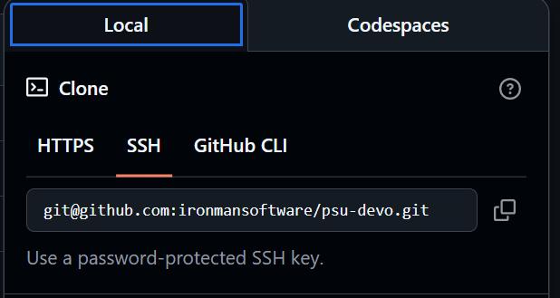

#### Example: SSH and GitHub
First, you will need to configure your local ssh-agent and GitHub account with SSH keys.
You can follow their [guide here](https://docs.github.com/en/authentication/connecting-to-github-with-ssh).
Next, you will provide a SSH URI for the git remote URL in PowerShell Universal. The configured SSH key will be used for the connection.
git@github.com:ironmansoftware/universal.git

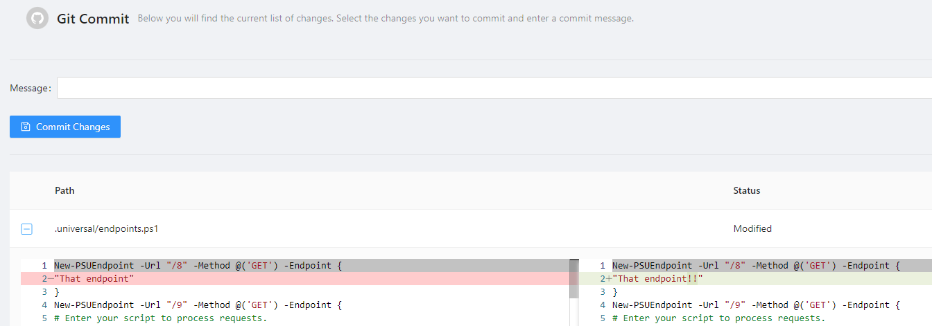

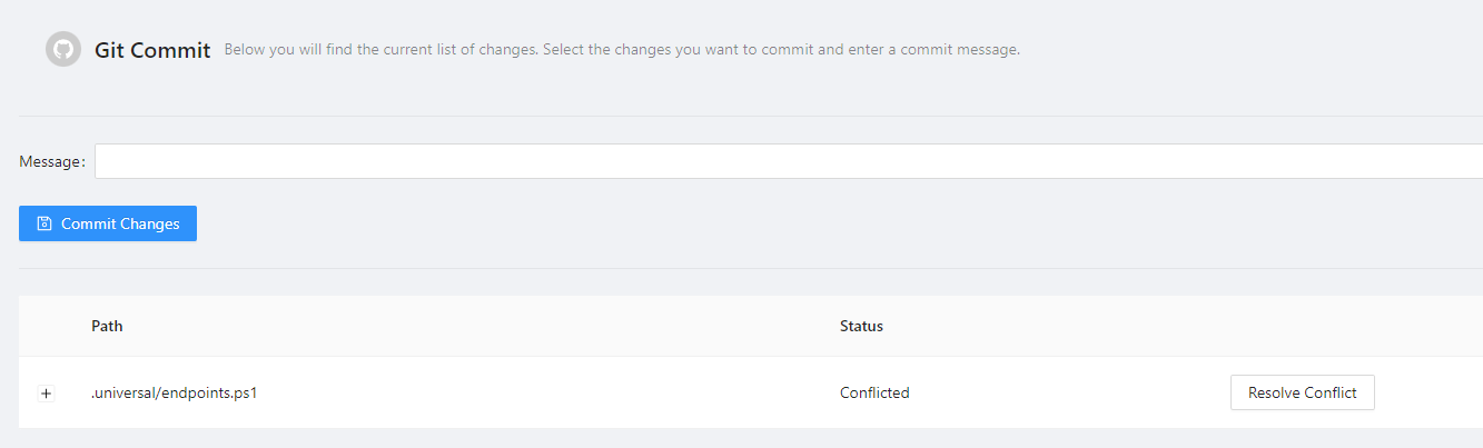

### Manual Mode

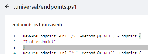

Manual mode requires users editing the PowerShell Universal instance to click Edit in order to make changes in the system.
<figure><img src="https://218893503-files.gitbook.io/~/files/v0/b/gitbook-x-prod.appspot.com/o/spaces%2FAje1UFQFSPx2kH2ueeCf%2Fuploads%2Fgit-blob-6ac8710e488361f83ef2abaec1dacc6186df6d3e%2Fimage%20(210).png?alt=media" alt=""><figcaption></figcaption></figure>
Once the changes are complete, the user can then click Save Changes to begin a commit
<figure><img src="https://218893503-files.gitbook.io/~/files/v0/b/gitbook-x-prod.appspot.com/o/spaces%2FAje1UFQFSPx2kH2ueeCf%2Fuploads%2Fgit-blob-4bc476112359e046efcb49ab75b92d0bfc0852ef%2Fimage%20(219).png?alt=media" alt=""><figcaption></figcaption></figure>

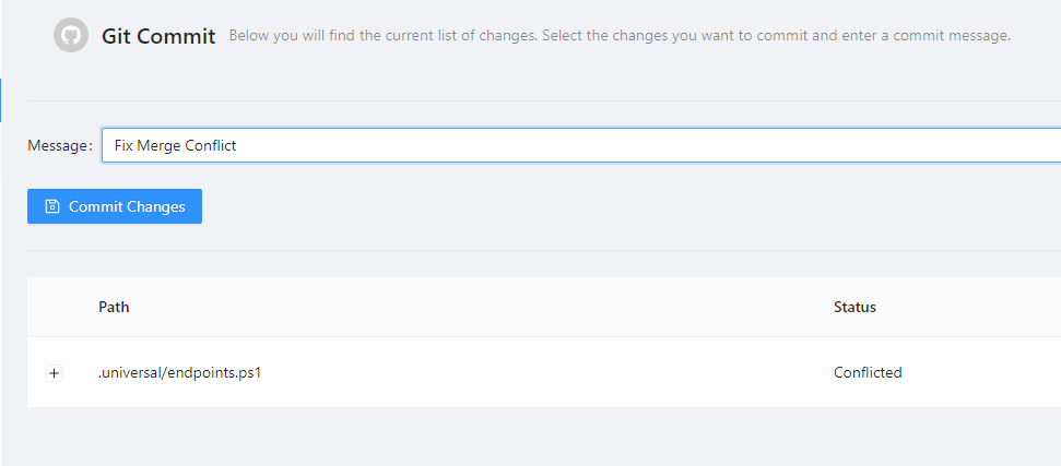

On the git commit page, you can view the changed files and enter a commit message.
<figure><img src="https://218893503-files.gitbook.io/~/files/v0/b/gitbook-x-prod.appspot.com/o/spaces%2FAje1UFQFSPx2kH2ueeCf%2Fuploads%2Fgit-blob-a54742d803130f00ebdabcb328c649d80a8444b1%2Fimage%20(466).png?alt=media" alt=""><figcaption></figcaption></figure>
Once changes have been committed, they will be pushed to the remote and the service will start to synchronize with git again. There is also a chance that a git merge conflict can take place at this time. See [Dealing with Conflicts](#dealing-with-conflicts) for more information.

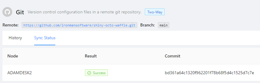

Replace `main` with your actual branch name. Then click **Synchronize Now** in PSU.

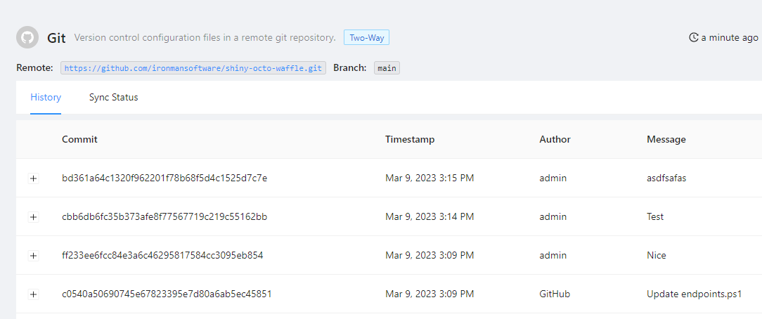

## Git History and Status Page
The history tab displays all the git commit history for the current repository.
<figure><img src="https://218893503-files.gitbook.io/~/files/v0/b/gitbook-x-prod.appspot.com/o/spaces%2FAje1UFQFSPx2kH2ueeCf%2Fuploads%2Fgit-blob-e1d2baede8e8d9f669755040c66d87d38128063f%2Fimage%20(256).png?alt=media" alt=""><figcaption></figcaption></figure>
The sync status tab displays the current status of nodes within the PSU cluster.
<figure><img src="https://218893503-files.gitbook.io/~/files/v0/b/gitbook-x-prod.appspot.com/o/spaces%2FAje1UFQFSPx2kH2ueeCf%2Fuploads%2Fgit-blob-be958f056c23b5a29ebf0c5b3b1ee2e9ddb1c02c%2Fimage%20(214).png?alt=media" alt=""><figcaption></figcaption></figure>

### Dealing with Conflicts
Conflict resolution is only available in manual git sync mode.
When multiple users are editing the PowerShell Universal configuration files, there may be conflicts. PowerShell Universal will display that a particular node is in a conflicted state when attempting to commit changes. You will see a list of changes that are conflicted on the git commit page. Click the Resolve Conflict button to view the conflict in an editor.

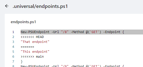

<figure><img src="https://218893503-files.gitbook.io/~/files/v0/b/gitbook-x-prod.appspot.com/o/spaces%2FAje1UFQFSPx2kH2ueeCf%2Fuploads%2Fgit-blob-83b03c04030558a380b24afca3bbc13687ac2408%2Fimage%20(7)%20(1)%20(1)%20(1).png?alt=media" alt=""><figcaption></figcaption></figure>
In this example, the string for this endpoint was edited on both the remote and the local repository.
<figure><img src="https://218893503-files.gitbook.io/~/files/v0/b/gitbook-x-prod.appspot.com/o/spaces%2FAje1UFQFSPx2kH2ueeCf%2Fuploads%2Fgit-blob-77400e45dd9019360aa2cb1cb679d362aa079494%2Fimage%20(226).png?alt=media" alt=""><figcaption></figcaption></figure>
Edit the text to remove the conflict.
<figure><img src="https://218893503-files.gitbook.io/~/files/v0/b/gitbook-x-prod.appspot.com/o/spaces%2FAje1UFQFSPx2kH2ueeCf%2Fuploads%2Fgit-blob-997bb1311d975b9b01de3c90c96de5f4ca2bec25%2Fimage%20(5)%20(1)%20(1)%20(1)%20(1)%20(1).png?alt=media" alt=""><figcaption></figcaption></figure>
Save the changes and navigate back to the git commit page. Enter a new commit message for the merge conflict and click Commit Changes.
<figure><img src="https://218893503-files.gitbook.io/~/files/v0/b/gitbook-x-prod.appspot.com/o/spaces%2FAje1UFQFSPx2kH2ueeCf%2Fuploads%2Fgit-blob-1008d76a9d319da2894aafd87b9ba2605e0245b3%2Fimage%20(469).png?alt=media" alt=""><figcaption></figcaption></figure>
This will resolve the merge conflict and push to the remote.
