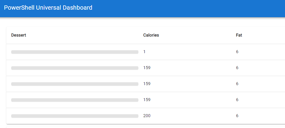

#### Long Running Renders
Due to the implementation details of `-Render`, it's not suggested to use long running render operations. If you expect your `-Render` to take more than a few milliseconds, consider using `New-UDDynamic` to off load the render back to the server and display a loading skeleton. The server can efficiently schedule the rendering operation using the runspace pool in this case.
An example of this is shown below.
```powershell
$Data = @(
    @{Dessert = 'Frozen yoghurt'; Calories = 1; Fat = 6.0; Carbs = 24; Protein = 4.0 }
    @{Dessert = 'Ice cream sandwich'; Calories = 159; Fat = 6.0; Carbs = 24; Protein = 4.0 }
    @{Dessert = 'Eclair'; Calories = 159; Fat = 6.0; Carbs = 24; Protein = 4.0 }
    @{Dessert = 'Cupcake'; Calories = 159; Fat = 6.0; Carbs = 24; Protein = 4.0 }
    @{Dessert = 'Gingerbread'; Calories = 200; Fat = 6.0; Carbs = 24; Protein = 4.0 }
$Columns = @(
    New-UDTableColumn -Property Dessert -Title Dessert -Render {
        New-UDDynamic -Content {
            Start-Sleep (Get-Random -Min 1 -Max 5)
            New-UDButton -Text "Click for Dessert!" -OnClick { Show-UDToast -Message $EventData.Dessert } -Variant 'text'
        } -LoadingComponent {
            New-UDSkeleton
    New-UDTableColumn -Property Calories -Title Calories
    New-UDTableColumn -Property Fat -Title Fat
    New-UDTableColumn -Property Carbs -Title Carbs
    New-UDTableColumn -Property Protein -Title Protein
The result is a table that loads immediately but displays loading skeletons in the slow-to-render columns.
<figure><img src="https://218893503-files.gitbook.io/~/files/v0/b/gitbook-x-prod.appspot.com/o/spaces%2FAje1UFQFSPx2kH2ueeCf%2Fuploads%2Fgit-blob-152cd1e662c50ff620fbe060bf9ea709af361eaf%2Fimage%20(375).png?alt=media" alt=""><figcaption></figcaption></figure>
