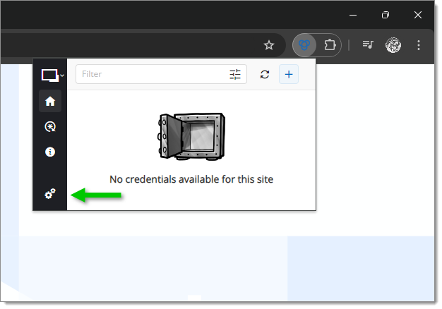

1. Click on the Devolutions Password Manager browser extension button in your browser, then click on the ***Settings*** button at the bottom of the ***Side menu***. The settings open in a new browser tab.

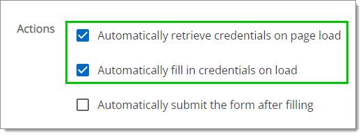

4. In the ***Actions*** section, check the boxes next to the following options:
   * ***Automatically retrieve credentials on page load*** (enabled by default): allows the Devolutions Password Manager browser extension to automatically search for available credentials when loading a web page.
   * ***Automatically fill in credentials on load*** (disabled by default): credentials fields are automatically filled in when loading a web page.
With these settings enabled, credentials are automatically filled in when loading a web page. This only works if you only have one set of credentials for a given website. Websites in the ***Never autofill*** or ***Never do anything*** categories of the ***Never list*** are never filled in automatically.
If the ***Automatically submit the form after filling it*** setting (disabled by default) is enabled, the credentials are automatically submitted when the fields are filled. Enabling it is optional as it is not a best practice.

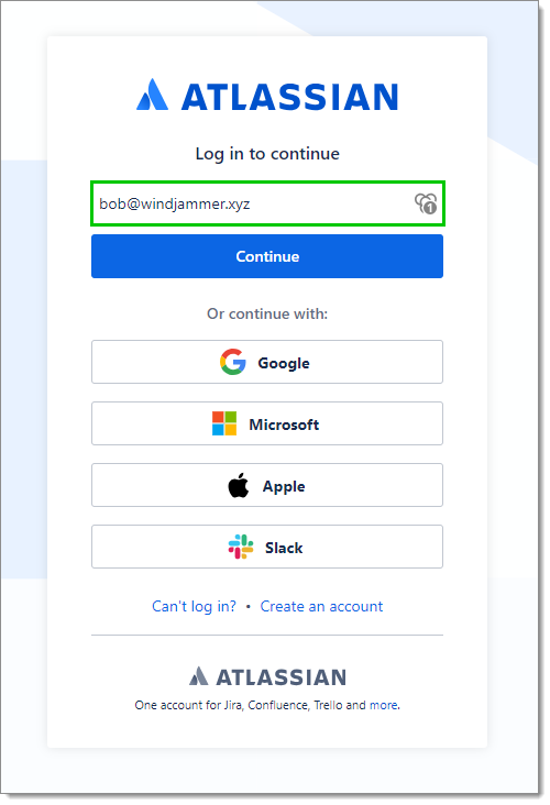

1. Go to the login page of the website you want to access. This page will be different for each website; this section will use the Atlassian website as an example. One of two scenarios can happen:
   1. If you only have one set of credentials for this website, the login fields should already be filled in with your credentials. If that is the case, follow the login process of the website until you successfully log in to your account. You do not have to follow the next step.

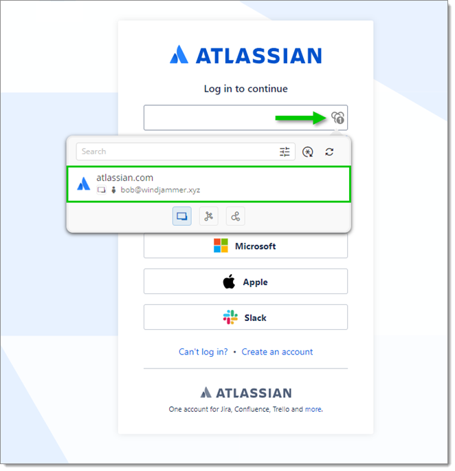

   2. If you have more than one set of credentials or if your credentials are not filled in, click on the Devolutions Password Manager browser extension icon in the credential field and select the entry that contains your credentials for that website. If multiple entries are available, you can search for the one you want using the search field at the top of the list. Follow the rest of the website's login process until you successfully log in to your account.

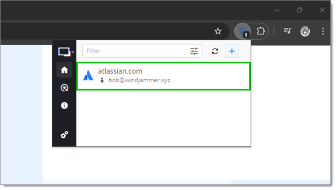

2. Click on the Devolutions Password Manager browser extension in your browser. The website entries that match this website appear in the ***Matching*** tab.
3. Click on the website entry that contains the credentials for this website. If multiple entries are available, you can use the search field to find the one you need.
   <div data-gb-custom-block data-tag="hint" data-style="info" class="hint hint-info"><p>If needed, you can also use the buttons that appear when hovering over the entry to copy your username, copy your password, or copy the one-time password.</p></div>
4. Your credentials are transferred to the credentials fields of the website and the extension window closes. Follow the rest of the website's login process until you successfully log in to your account.
