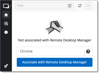

  1. Open Remote Desktop Manager and keep it running, then click on the Devolutions Password Manager browser extension icon in any browser.
  2. Choose Remote Desktop Manager in the list.
  3. Enter a name for this association in the text box.
  4. Click on Associate with Remote Desktop Manager.
  5. Click Yes in Remote Desktop Manager to accept the association request.

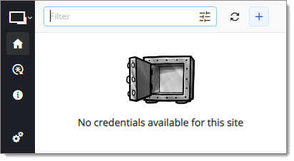

  6. Click on the icon in the web browser to validate that the Devolutions Password Manager browser extension is now paired to Remote Desktop Manager.
    Note that, while Remote Desktop Manager can handle multiple associations (e.g., multiple browsers), the Devolutions Password Manager browser extension can only be paired to a single instance of Remote Desktop Manager at any time.
