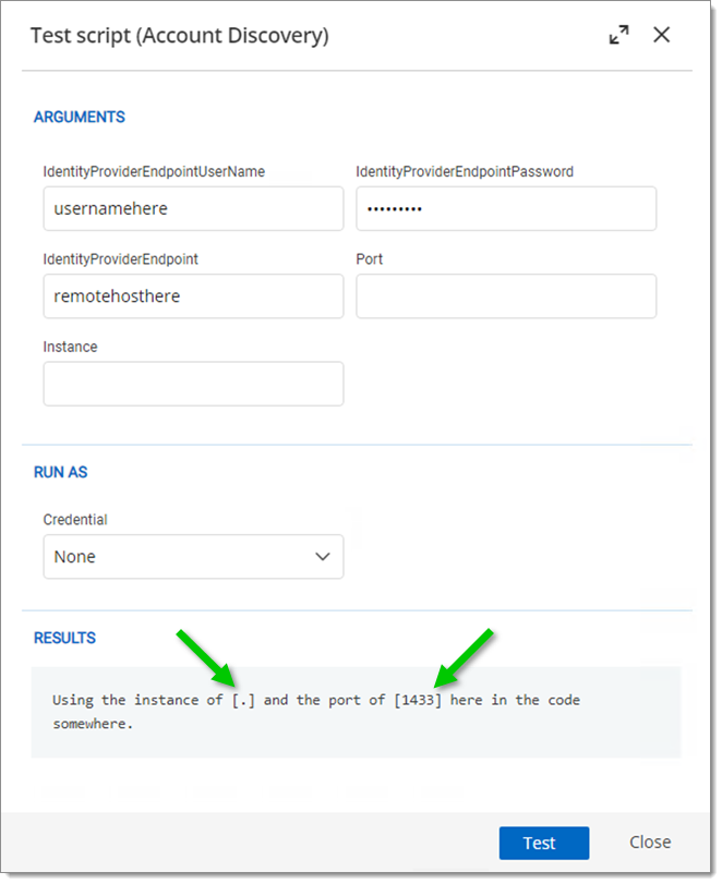

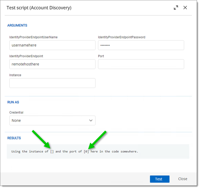

However, when constructing the custom PAM provider template and providing only the mandatory parameters, relying on the script’s internal default values, custom PAM providers overrides these defaults.
When custom PAM providers executes an action script, it invariably passes values to all parameters. In instances where no value is defined, custom PAM providers pass a `null` value, or if the parameter is of an integer type, a `0` value.
To circumvent this, default values should not be set within the script parameters. Instead, conditions within the script should determine default values.
```powershell
[CmdletBinding()]
param(
    [Parameter(Mandatory)]
    [string]$IdentityProviderEndpoint,
    [string]$IdentityProviderEndpointUserName,
    [securestring]$IdentityProviderEndpointPassword,
    [Parameter()]
    [string]$Instance,
    [Parameter()]
    [int]$Port
if (!$Instance) { $Instance = '.' }
if (!$Port) { $Port = 1433 }
Write-Output "Using the instance of [$Instance] and the port of [$Port] here in the code somewhere."
Although it is not generally recommended by PowerShell best practices, providing default parameter values in this manner is a requirement for custom PAM providers.

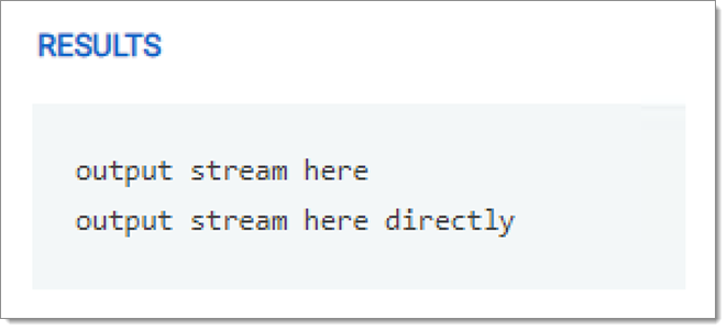

### Handling output
Action scripts are ultimately executed within the custom PAM providers environment. Any output they generate is interpreted, stored, and/or displayed in the Devolutions Server web interface.
To ensure that action scripts produce the expected output, it is recommended that they return output in only four ways:
* Use the `throw` keyword to generate a terminating error using the error stream.
* Use the `Write-Error` cmdlet to generate a non-terminating error using the error stream.
* Use the `Write-Output` cmdlet to return information to the output stream.
* Output information directly to the output stream.
Below are examples of action scripts and the corresponding results within the ***Test script*** functionality of custom PAM providers’ ***Results*** area.

```powershell
Write-Verbose -Message 'This is a verbose message.'
Write-Information -MessageData 'information action'
Write-Output 'output stream here'
'output stream here directly'
Write-Host 'write-host output here'
{% hint style="success" %}
To ensure that an action script returns information to the custom PAM provider, it is advised **not** to use `Write-Verbose`, `Write-Information`, or `Write-Host`.

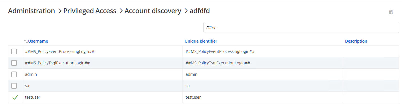

The initial action executed by a custom PAM provider is the account discovery action, which enumerates the accounts on an identity provider and populates the Devolutions Server database for subsequent management.
* **Required input parameters**
  The account discovery action script is relatively straightforward, as it primarily requires common endpoint script parameters. No additional parameters are necessary unless dictated by the specific identity provider.
* **Required output**
  Each account discovery action script must return one or more `PSCustomObject` type objects, with each object representing an individual account and containing three properties: `id`, `username`, and `secret`.
  * The `id` property must serve as a unique identifier for each account. While this identifier is typically a username, it can be any unique identifier for the account.
  * The `username` property should serve as a label for each account. This label is generally a username but can be any identifier that represents the account.
  * The `secret` property is the password identifier. This can take the form of an encrypted string or a plaintext password, which is then used to compare with other secrets via the heartbeat action.
  If the identity provider's code does not natively return this object with the specified properties, it is necessary to convert it by creating a `PSCustomObject`. Below is an example of how to accomplish this.
