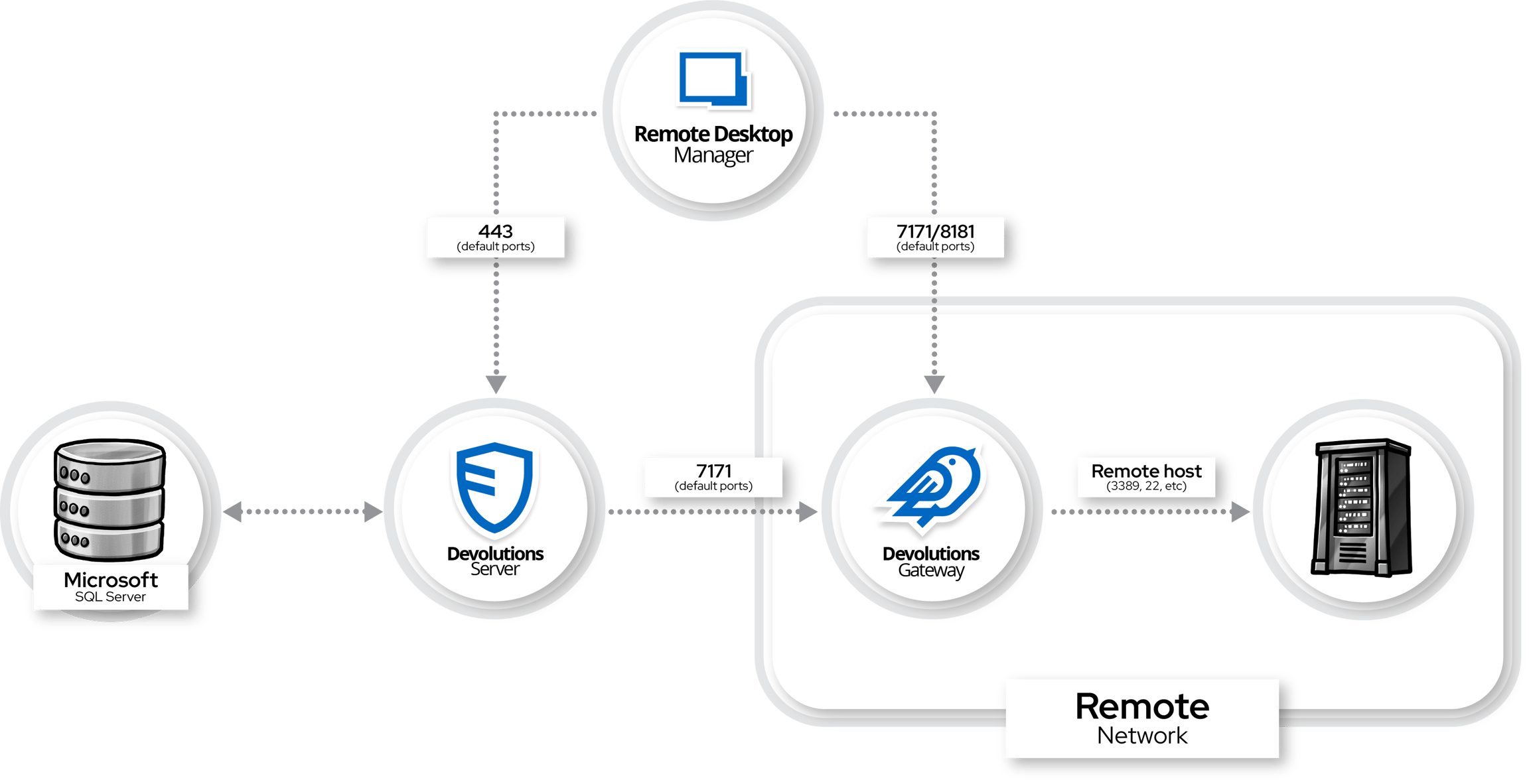

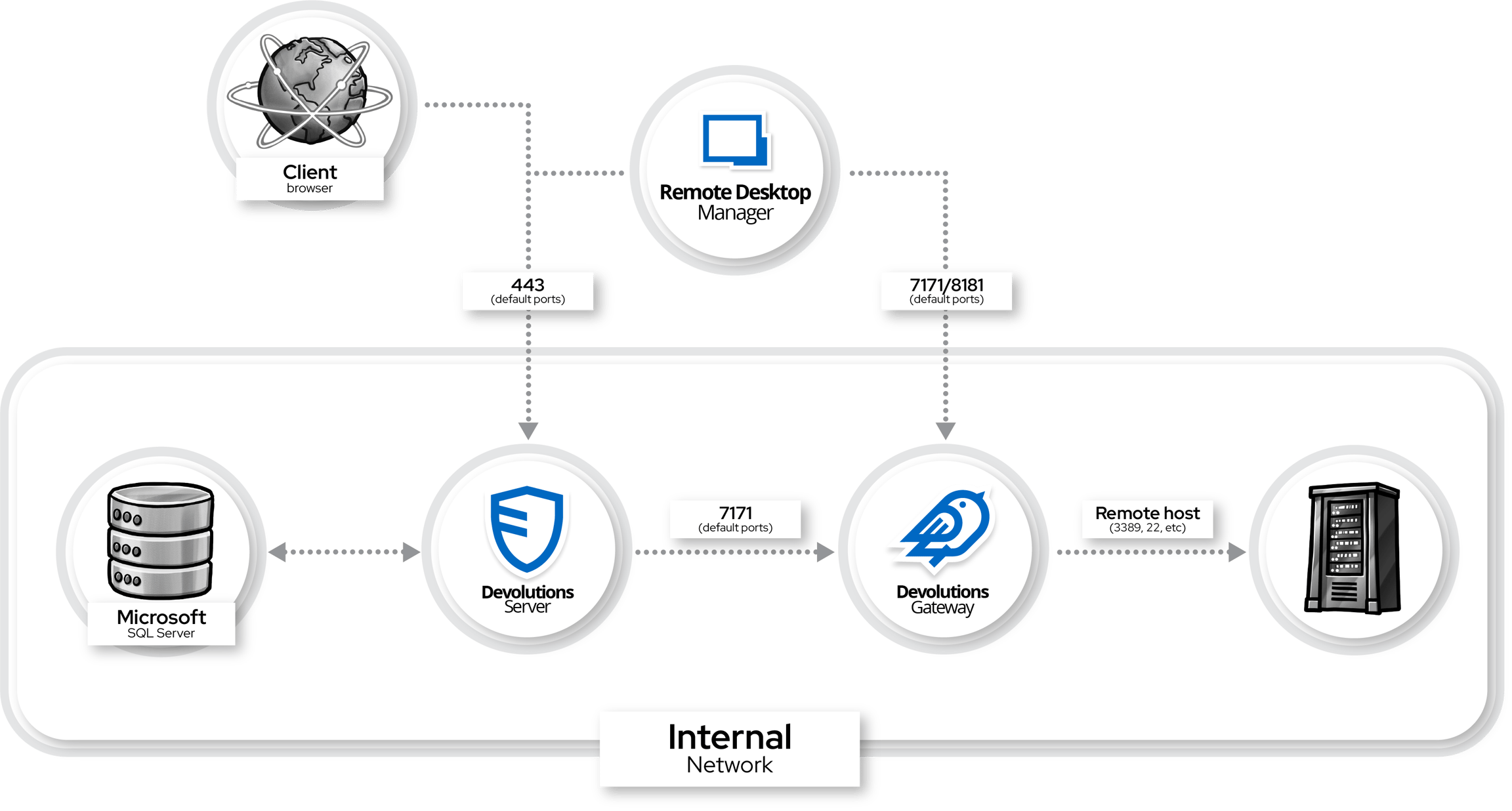

When installing Devolutions Gateway, it is essential to consider the location of the resources you need to access and the location of the users requiring access to those resources. Devolutions Gateway can be deployed in two ways:
* **Internal network**: Devolutions Gateway is installed on the same internal network as Devolutions Server, its SQL Server database, and the target hosts.
* **Remote network**: Devolutions Gateway is installed on a separate network — closer to the target hosts — while Devolutions Server and its SQL Server database remain on the internal network.
In both cases, the same connections and default ports apply:
* The client browser connects to Devolutions Server over port **443** (default ports).
* Devolutions Server connects to Devolutions Gateway over port **7171** (default ports).
* Remote Desktop Manager connects directly to Devolutions Gateway over ports **7171/8181** (default ports) — this connection bypasses Devolutions Server entirely.
* Devolutions Gateway connects to the target remote host using the protocol's default port (for example, 3389 for RDP, 22 for SSH).
The communication between Remote Desktop Manager / Devolutions Server and the gateway is encrypted to ensure secure data transfer. However, between the gateway and the target host, the connection will use the default protocol associated with the connection type, such as RDP or SSH. It is important to ensure that these protocols are properly secured. The default port for HTTP(s) communication with the gateway is **7171**, while the default port for TCP communication is **8181**. These ports should be open and not blocked by firewalls to allow proper communication.
The interaction between Remote Desktop Manager and Devolutions Gateway is direct and does not pass through Devolutions Server. Security is maintained through the use of a user token, which is encrypted and authenticated using a PEM file to verify that the token was generated by Devolutions Server. This ensures the integrity of the connection and protects against unauthorized access.
For optimal performance, the gateway should be installed as close as possible to the resources it accesses. Additionally, administrators should regularly monitor and update firewall rules to allow the required ports (7171 and 8181) and ensure secure configurations for the protocols in use. Proper handling of the PEM file is critical to maintaining a secure setup.
