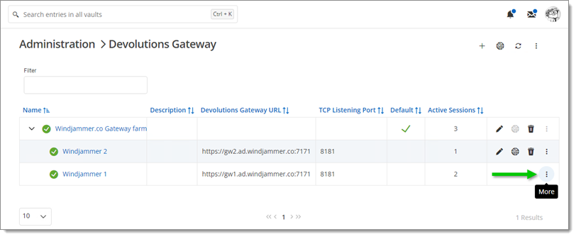

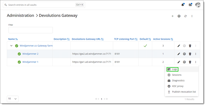

1. In the Devolutions Server web interface, go to ***Administration*** – ***Devolutions Gateway***.
2. Open the menu of the gateway row.

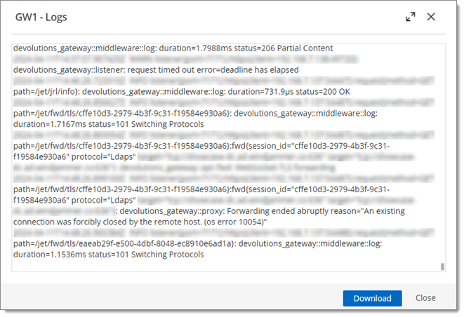

3. Select ***Logs*** to read, search, copy or download the log files of the gateway. ***Log file*** lists the files, the most recent first.

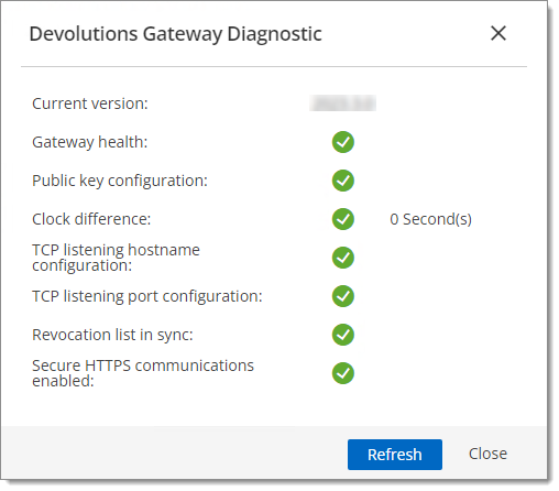

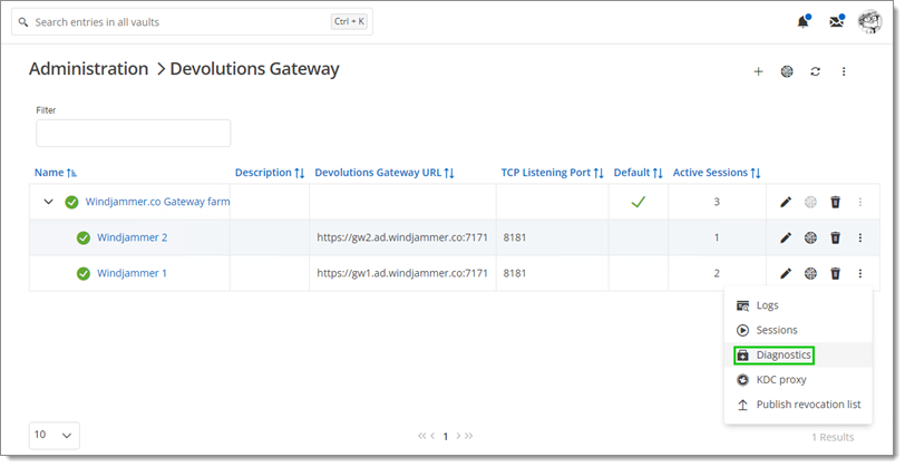

4. Select ***Diagnostic*** to see these checks:
<table><thead><tr><th width="280">ROW</th><th>WHAT TO CHECK</th></tr></thead><tbody><tr><td><strong>Current version</strong></td><td>Version of Devolutions Gateway. "&#x3C; 2022.1.1" means the gateway doesn't report it.</td></tr><tr><td><strong>Gateway health</strong></td><td>Whether Devolutions Server reaches the gateway.</td></tr><tr><td><strong>Public key configuration</strong></td><td>Whether the gateway accepts the tokens of Devolutions Server: <code>provisioner.pem</code> on the gateway must be the public key of Devolutions Server.</td></tr><tr><td><strong>Clock difference</strong></td><td>Difference between the clocks of Devolutions Server and Devolutions Gateway, in seconds. Over 30 seconds, Devolutions Server warns.</td></tr><tr><td><strong>TCP listening hostname configuration</strong>, <strong>TCP listening port configuration</strong></td><td>Whether the TCP host name and port saved in Devolutions Server match the gateway's TCP listener.</td></tr><tr><td><strong>Revocation list in sync</strong></td><td>Whether the gateway has the latest token revocation list. Fix with <em><strong>Publish revocation list</strong></em>.</td></tr><tr><td><strong>Secure HTTPS communication enabled</strong></td><td>Whether the gateway URL uses HTTPS.</td></tr><tr><td><strong>Agent installed</strong>, <strong>Agent version</strong></td><td>Whether Devolutions Agent runs on the computer of the gateway, needed for updates from Devolutions Server.</td></tr></tbody></table>
Remote Desktop Manager shows the same information in ***Administration*** – ***Devolutions Gateway***, in the ***Logs*** and ***Diagnostics*** tabs of the details pane. In Devolutions Cloud, ***Logs*** is in the ***More*** menu of the gateway row in ***Administration*** – ***Devolutions Gateway***.

If you can't download the logs from the web interface, read them in the data folder: `C:\ProgramData\Devolutions\Gateway` on Windows, `/etc/devolutions-gateway` on Linux. The files are named `gateway.*.log`. For more detail, set `"VerbosityProfile": "Debug"` (or `"Tls"` for certificate problems) in `gateway.json` and restart the service. Everything about logs and Windows events: [Logs and event IDs](https://docs.devolutions.net/gateway/help/troubleshooting/logs-and-events.md).
