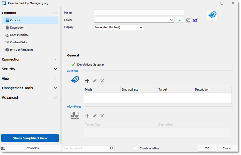

The Devolutions Gateway tunnel can fulfill similar needs to SSH port forwarding/SSH tunneling, but it requires nothing other than Devolutions Gateway itself. It is useful when using connections that do not have built-in support in Remote Desktop Manager through the Devolutions Gateway. The entry can be found under New Entry – Session – Remote Connections.
Devolutions Gateway needs to be set up in the Remote Desktop Manager workspace and then configured through inheritance or on the connection itself. The option is under Properties – Connection – VPN/SSH/Gateway – VPN/SSH/Gateway – General.
Listeners
  • In almost every scenario, the listener (bind address) should be set to the loopback address (127.0.0.1) from the local machine.
  • TCP Forward: It is the equivalent to port forwarding.
  • HTTP and SOCKS5 proxies: These listeners are set up as proxies which makes it possible to use a browser other than Google Chrome. This also means they use a dynamic destination.
    Dynamic ports can be used with all three listener types. If the value is 0, it will automatically find an available port.

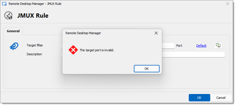

Allow Rules
The HTTP and SOCKS5 listeners will also make use of the Allow Rules to specify authorized destinations, anything not on the allow list will be denied.
Target filters can be specified using IP addresses or hostnames. Both can contain wildcards. Each Target filter must explicitly specify a destination port. Leaving the default port as '0' will result in an error ("The target port is invalid.") when attempting to save the filter.
