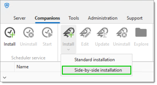

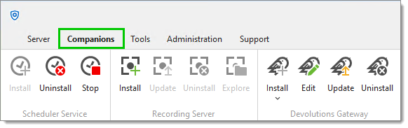

  1. From the Devolutions Server Console, click on the Companions tab.
  2. In the Devolutions Gateway section, click on Install.

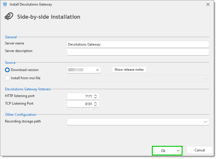

  3. Choose Side-by-side installation.
    It is possible to download an .msi file to install Devolutions Gateway on an offline Devolutions Server.
  4. If default values do not work for your environment, enter the desired settings.
    • HTTP Listener: HTTP(s) port to reach the Gateway. (7171 is default)
    • TCP Listener: port used for the RDP sessions. (8181 is default)
  5. Click OK.

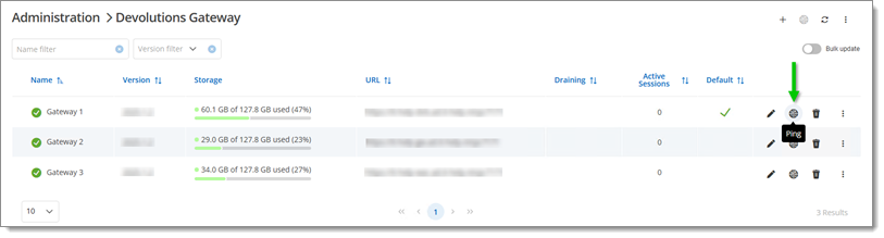

  6. Go to the Devolutions Server web interface, connect with an administrator account.
  7. Go to Administration – Devolutions Gateway.
  8. Click on the Ping button for the desired gateway in the list to see if a connection can successfully be made. If the page was already open, refresh it first.

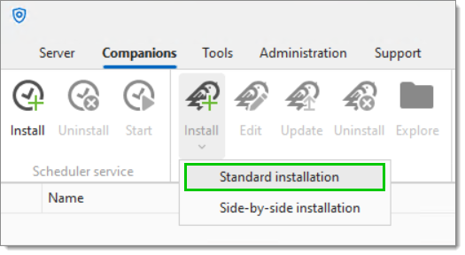

  3. Choose Standard installation.

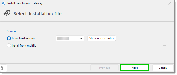

  4. Choose between Download version and Install from .msi file.
  5. Click Next.

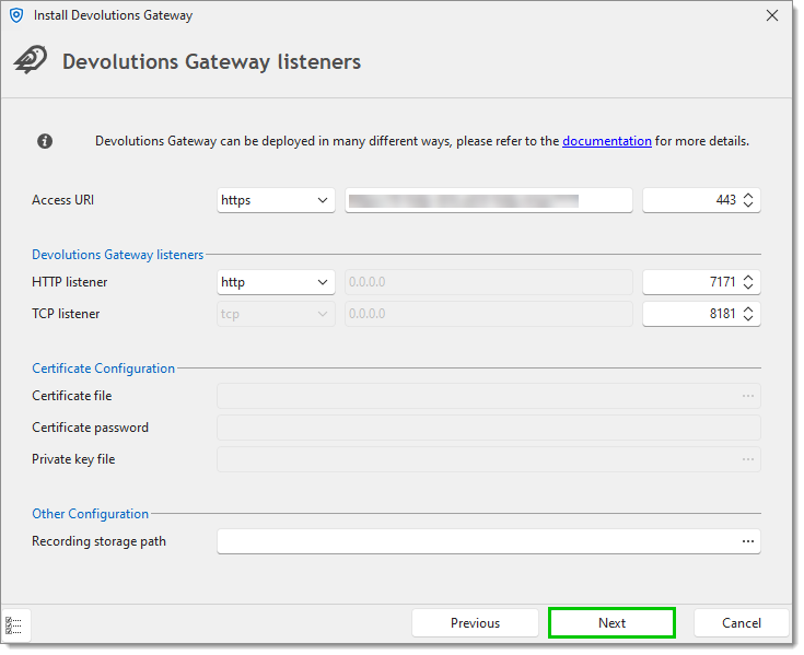

  6. Enter the Access URI information, for example https://gateway.example.com.
  7. Choose the Devolutions Gateway Listeners ports (by default they are 7171 and 8181). Devolutions Server will use the Access URI port (usually 443 or 7171) for health checks and initial configuration. Remote Desktop Manager will use ports 7171 and 8181 to connect to the Gateway. For instance, a web session using the Gateway will connect on port 7171, as will any registration via Devolutions Gateway. Port 8181 is used by sessions such as RDP.
    • If HTTPS is chosen instead of HTTP in the step above, the Certificate configuration will be needed.
    • Certificate file: Needs to be a full chain certificate (.pfx, .p12, .pem, .crt).
    • Certificate password: Only needed if a .pfx or .p12 certificate was used.
    • Private key file: Only needed if a .pem or .crt was used as a certificate.
  8. Click Next.

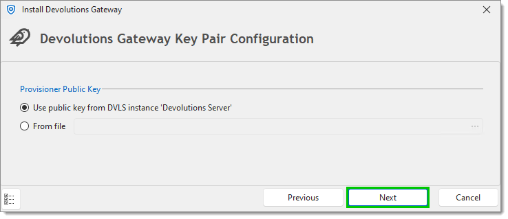

  9. Choose between:
    • Use public key from Devolutions Server instance 'Devolutions Server': this option is used if the installed Devolutions Gateway is on the same server as the Devolutions Server;

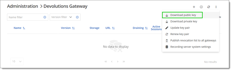

    • From file: If installing Devolutions Gateway on another computer, download the public key from the Devolutions Server you want to pair with that Devolutions Gateway. It is located under Administration – Devolutions Gateway.
  10. Click Next.
    If Devolutions Server is not installed locally, then check the From file option, and select Devolutions Gateway's .json configuration file .See Configuring Windows certificate store via gateway.json for a typical configuration file.

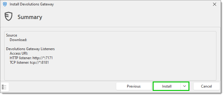

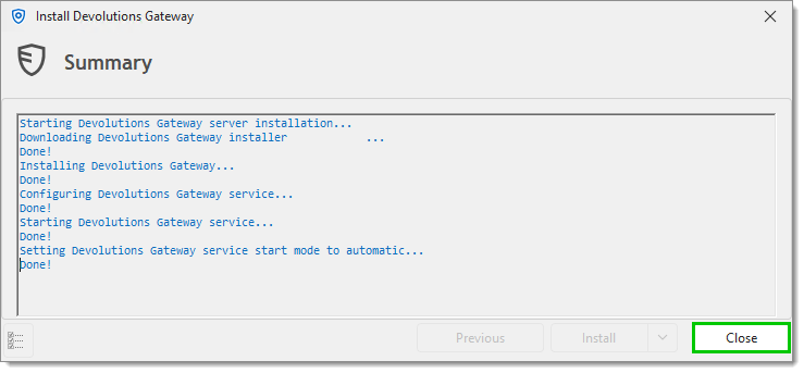

  11. Click Install.
  12. Click Close.
  13. On the Devolutions Server web interface, connect with an administrator account.
  14. Go to Administration – Devolutions Gateway.

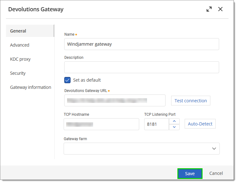

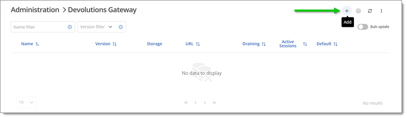

  15. Click on the Add button on the top right corner.
  16. Enter the following information.
    • Name: Name of the gateway that will be displayed in Remote Desktop Manager.
    • Description: Description of the gateway.
    • Set as default: If enabled, this gateway will be selected by default when configuring Remote Desktop Manager.
    • Devolutions Gateway URL: The Devolutions Gateway URL and Port that Devolutions Server will connect to, for example: https://gateway.example.com:7171.
    • TCP Listening Port: Set the port with the same TCP port value configured in the Devolutions Server Console.
    • TCP hostname: It should be resolvable by the machine initiating the connection (Remote Desktop Manager).
  17. Click Save.

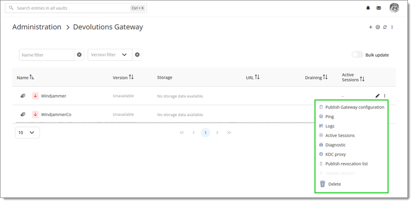

The gateway should now be visible in the list. It is possible to verify the status of the gateway with the Ping button.
  1. Publish the Devolutions Gateway configuration.
  2. Publish the Revocation list.

  • Update manually through the Devolutions Server Console. To do so, head over the Companions tab, select the Devolutions Gateway to update, click the Update button, and follow the instructions then provided.
