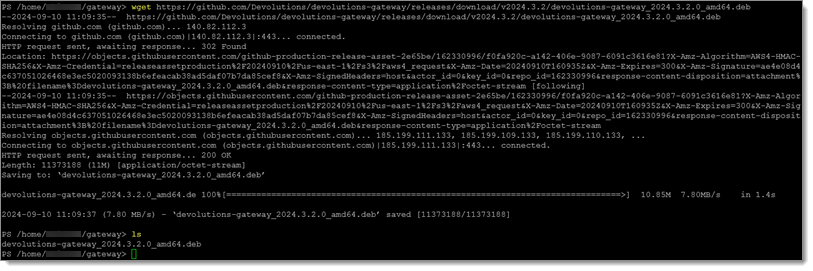

Install Devolutions Gateway
  1. Navigate to the Devolutions Gateway GitHub Release page and download the .deb file of the latest release.
  2. Input the following using the command-line: wget https://github.com/Devolutions/devolutions-gateway/releases/download/v2024.3.2/devolutions-gateway_2024.3.2.0_amd64.deb

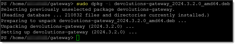

  3. Install the package using the dpkg utility: sudo dpkg -i devolutions-gateway_2024.3.2.0_amd64.deb

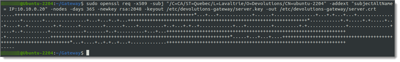

Generate a self-signed certificate on Ubuntu 22.04 LTS via OpenSSL
Using the OpenSSL utility, generate a certificate directly from the command line. The certificate then needs to be placed directly into the configuration directory /etc/devolutions-gateway.
The certificate request will look different for every configuration.
Note that the certificate must include a Subject Alternative Name (SAN) extension with either a DNS name or an IP address, and it should also contain the Extended Key Usage (EKU) extension with the Server Authentication purpose (serverAuth). This is required because modern operating systems and browsers, including Google Chrome and macOS, will reject certificates that are missing a SAN or the appropriate EKU, even if the Common Name (CN) is set. It’s possible to relax this requirement by setting the TlsVerifyStrict option to false if necessary, but this is not recommended.

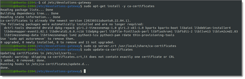

Once the self-signed certificate is created the certificate within the Ubuntu system will need to be trusted. To trust system-wide use the following set of commands:
The ca-certificates may already be installed. By running the update-ca-certificates command a symlink will be created in /etc/ssl/certs to the copied certificate file in /usr/local/share/ca-certificates.

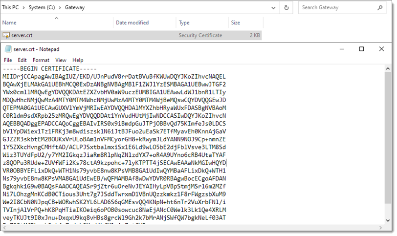

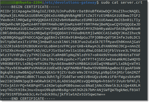

1. Copy the public key to Windows (in the example, C:\Gateway is a temporary location): sudo cat server.crt
  1. Copy the content into a server.crt file.

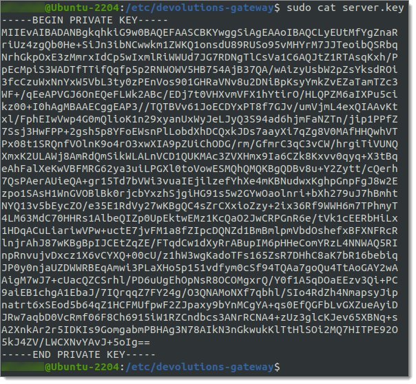

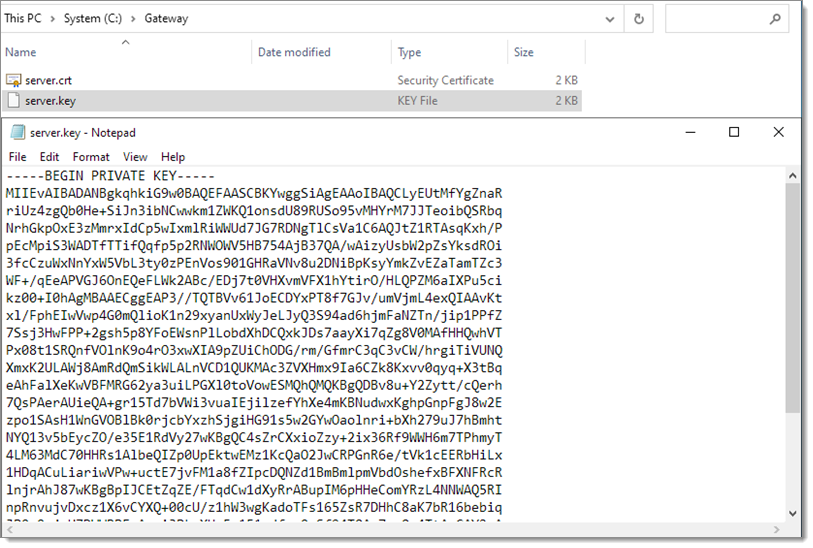

  2. Copy private key to Windows: sudo cat server.key
  3. Copy the content into a server.key file.

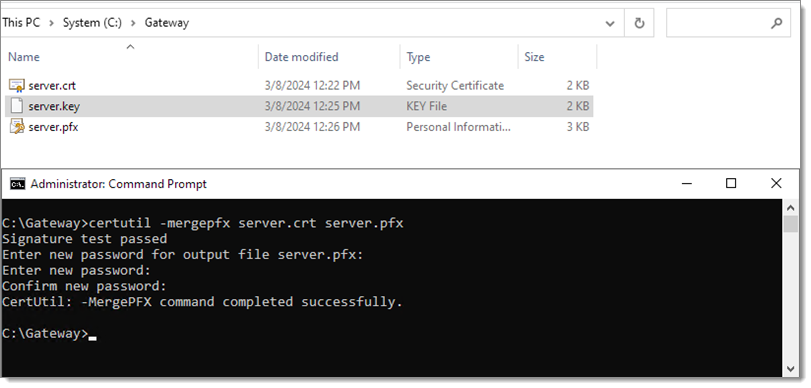

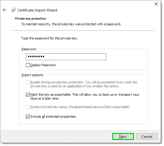

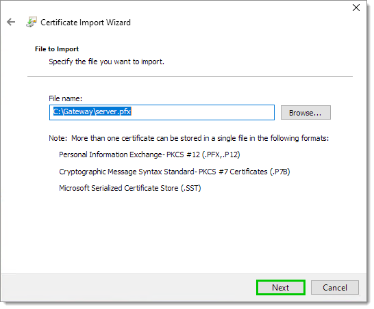

  4. Create a PFX file using the Windows certutil command-line tool. For this to work, the key file must be named the same as the crt file, only differing in extension: certutil -mergepfx server.crt server.pfx

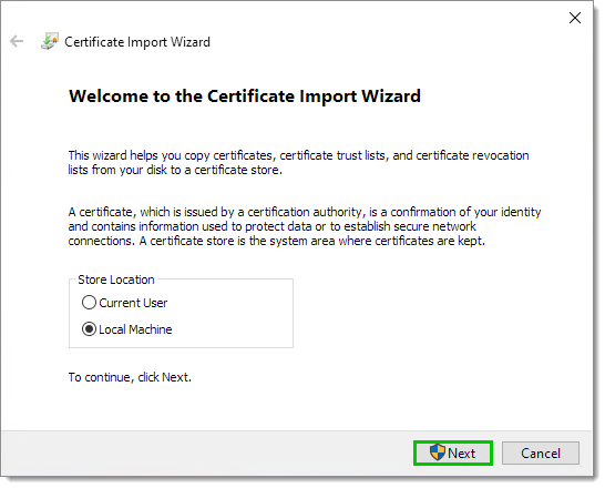

    1. Double-click the server.pfx file to start the import wizard and choose Local Machine.
    2. Click Next and accept the prompt.
    3. Click Next.
    4. Enter the password that you entered with the certutil command.
      • Optionally: choose to Mark this key as exportable.

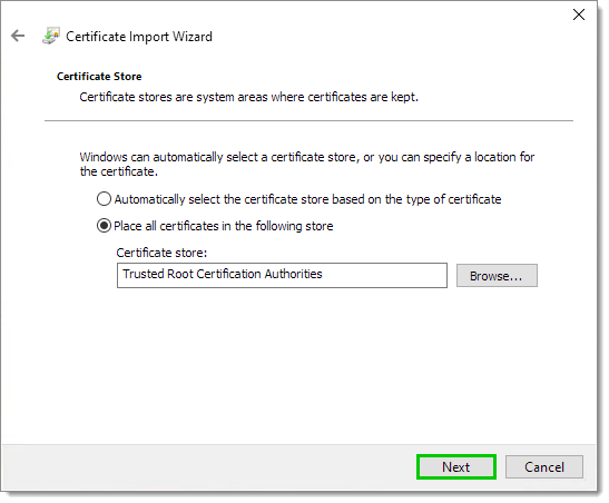

    5. Choose the option Place all certificates in the following store.
    6. Select Trusted Root Certification Authorities with the Browse... button.
    7. Click Next.
    8. Click Finish to complete the import.

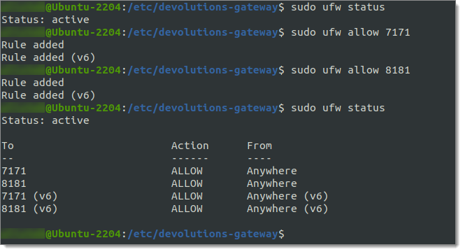

Open Ubuntu firewall ports
If the Linux system uses UFW (Uncomplicated Firewall) to manage iptable-based firewall, perform the following commands to open the necessary ports:

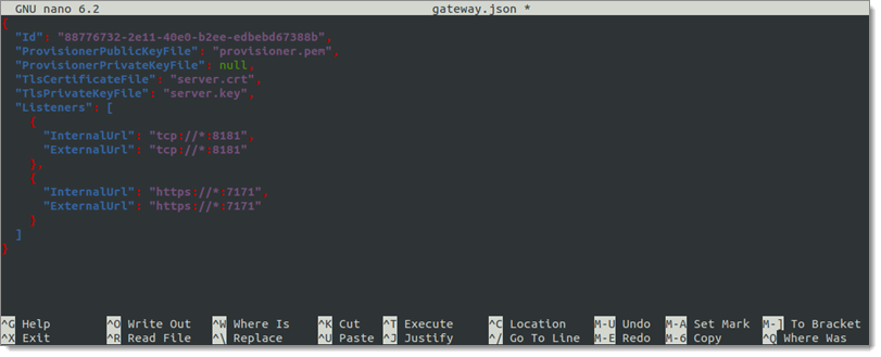

Modify the Devolutions Gateway configuration
The default configuration of a gateway contained in the /etc/devolutions-gateway/gateway.json file needs the certificate directives added (the InternalUrl will need to use HTTPS):
Modify the above file to reflect the following, assuming that both server.crt and server.key are in the same directory as gateway.json (using the built-in file editor Nano is recommended):

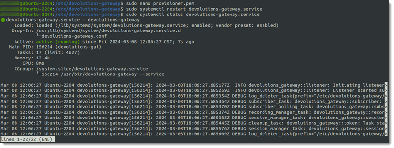

Restart Devolutions Gateway
With the new configuration in place restart Devolutions Gateway. This can be done with the systemctl command:
Alternatively the Stop-DGateway and Start-DGateway PowerShell commands can also be used.

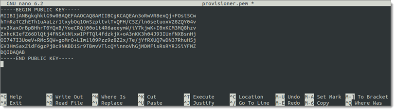

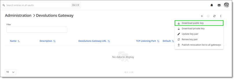

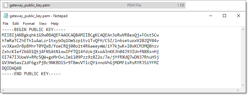

Copy the Public Key from Devolutions Server to Devolutions Gateway Linux
  1. Log into the Devolutions Server web console and navigate to Administration – Devolutions Gateway.
  2. Click the More button and choose the Download public key option.
  3. Copy the contents of the downloaded gateway_public_key.pem file on Windows.
  4. Replace the contents of the /etc/devolutions-gateway/provisioner.pem (the Nano utility is recommended) file with the copied contents from Windows.
  5. Restart Devolutions Gateway with the command sudo systemctl restart devolutions-gateway.service.

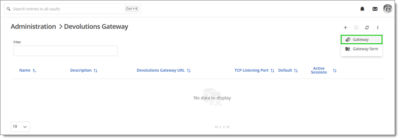

Configure Devolutions Gateway in Devolutions Server

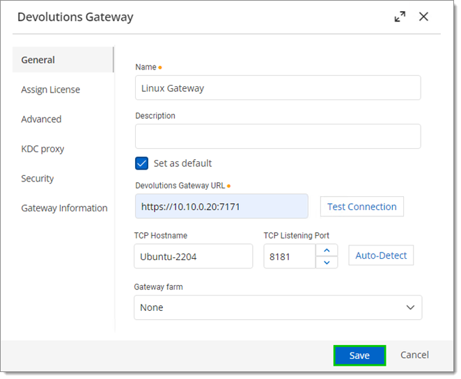

Go to the Devolutions Server web interface where the newly configured Linux Devolutions Gateway will be added.
  2. Click the Add (+) button.
  3. Select Gateway.
  4. Enter the following (this will change depending on the configuration).
    1. Name: Linux Gateway
    2. Devolutions Gateway URL: https://10.10.0.20:7171
    3. TCP Hostname: Ubuntu-2204
  5. Click Save.

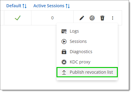

    Click the More options menu for the gateway and choose the Publish revocation list option if the revocation list is out of date.

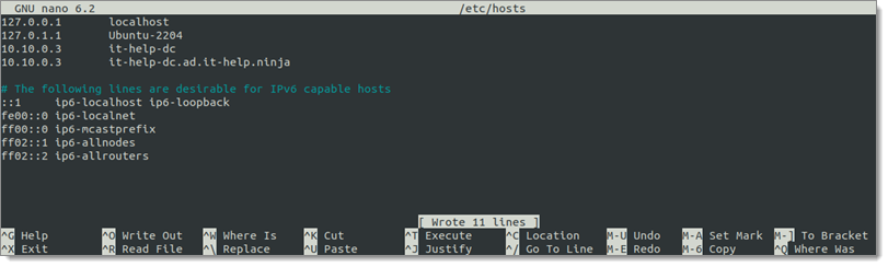

Resolve hosts in Ubuntu
The Linux-hosted Devolutions Gateway system must be able to resolve the addresses that are requested by Devolutions Server. The simplest method for testing is to modify the hosts file.
Connect to the following system:
  • Hostname: it-help-dc
  • Fully-Qualified Domain Name (FQDN): it-help-dc.ad.it-help.ninja
  • IP Address: 10.10.0.3
Open the hosts file for editing sudo nano /etc/hosts to add the host in Ubuntu.

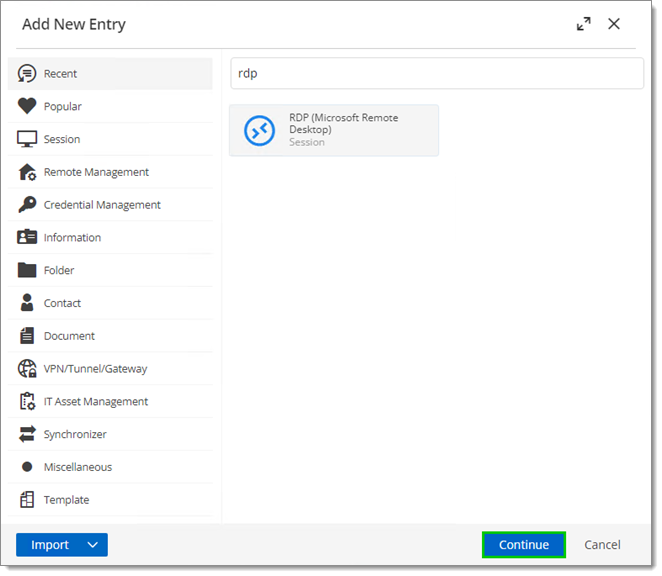

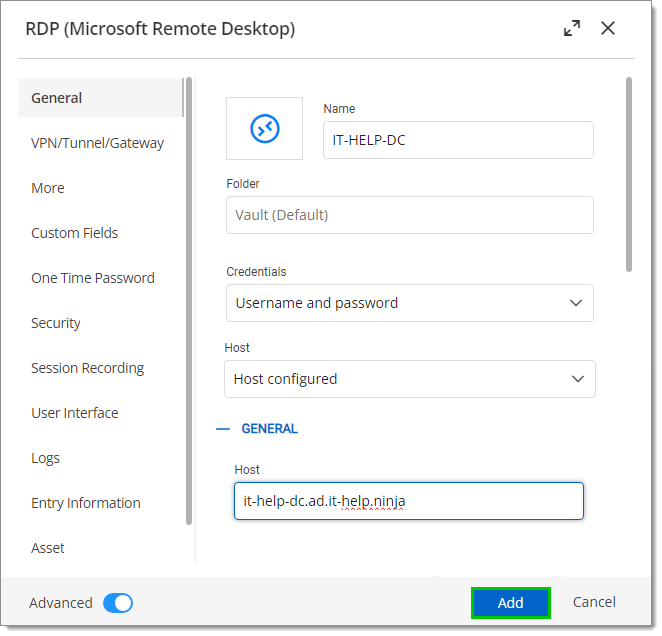

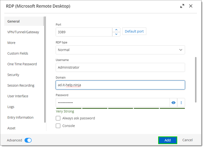

  1. In the Devolutions Server web UI click on Add. Select an RDP session entry.
  2. Click Continue.

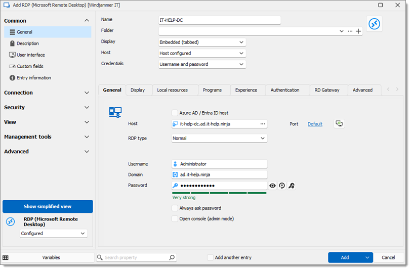

  3. Enter a Name and Host which must be resolvable by the Linux Devolutions Gateway install.
  4. Click Add.
  5. Enter or link any necessary credentials to the RDP session and click Add.

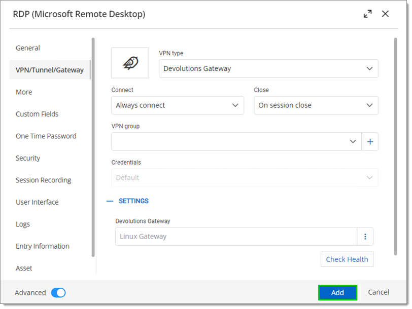

  6. Under the VPN/Tunnel/Gateway tab choose Devolutions Gateway as the VPN type.
  7. Set the Connect option to Always connect.
  8. Choose the correct gateway.
  9. Click Add.

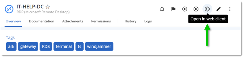

  10. Click Open in web client.

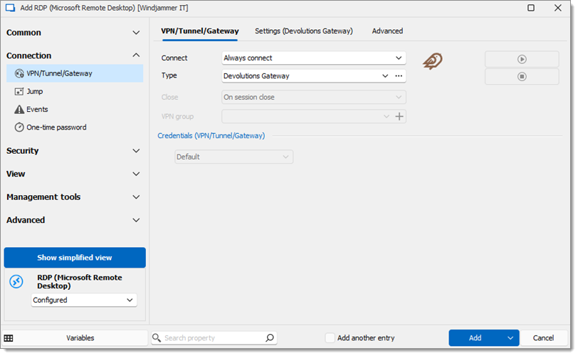

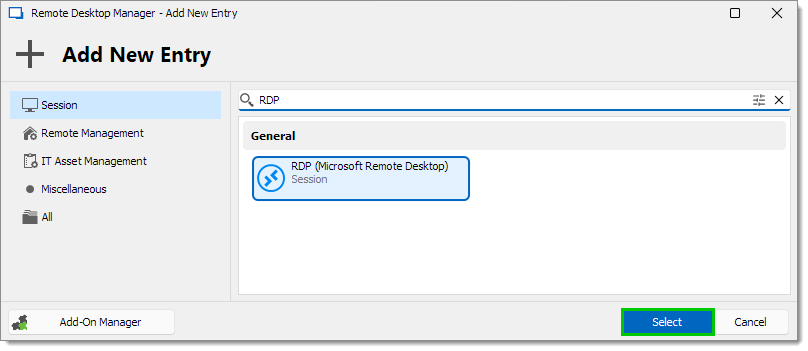

  1. In Remote Desktop Manager, click on New entry. Select an RDP session entry.
  2. Click on Select.
  4. Enter or link any necessary credentials to the RDP session.
  5. Set the Connect option to Always connect.

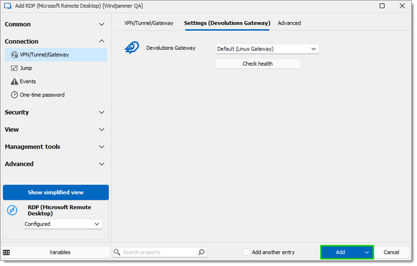

  7. Go to the Settings (Devolutions Gateway) sub-tab.
  8. Choose the desired Devolutions Gateway.
  9. Click Add.

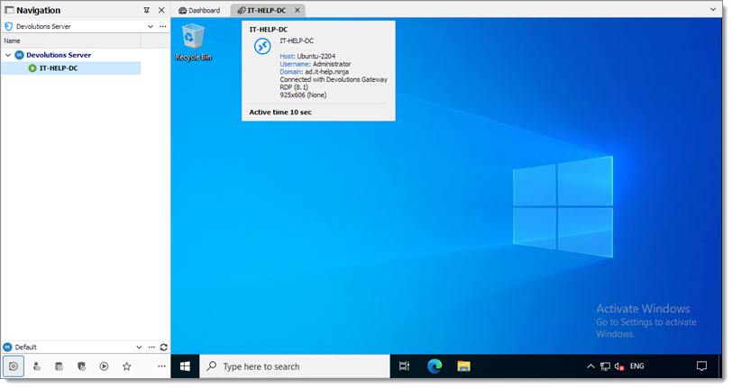

  10. Click on the Open session button.
    By hovering over the title bar a tooltip will appear and show that the RDP is connected via Devolutions Gateway.
