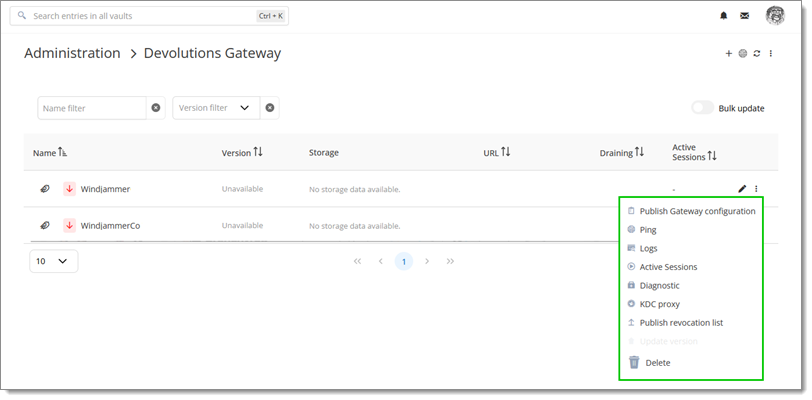

Go to the Devolutions Server web interface, connect with an administrator account.
Go to Administration – Devolutions Gateway.
Click on the Ping button for the desired gateway in the list to see if a connection can successfully be made. If the page was already open, refresh it first.

On the Devolutions Server web interface, connect with an administrator account.
Click on the Add button on the top right corner.

The gateway should now be visible in the list. It is possible to verify the status of the gateway with the Ping button.
Publish the Devolutions Gateway configuration.
Publish the Revocation list.
