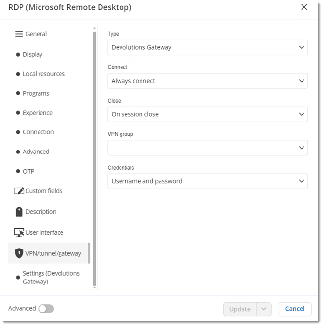

1. Go to the ***Properties*** of the entry.
2. Click ***VPN/tunnel/gateway***.
3. Select ***Devolutions Gateway*** under ***Type***.
4. Click ***Always connect***.

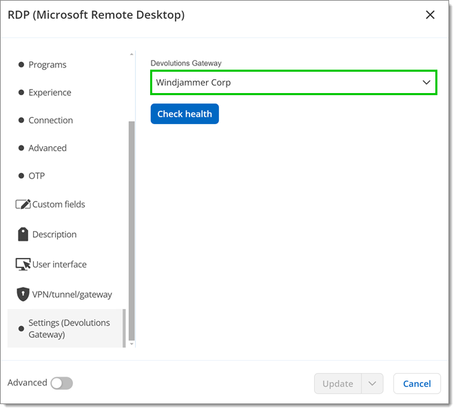

5. Go to ***Settings (Devolutions Gateway)***.
6. Select the Devolutions Gateway to use for this connection, then click on ***Check Health*** to make sure the Gateway is functional. Its version must be 2023.1 or later.
7. Click ***Update*** to save.
